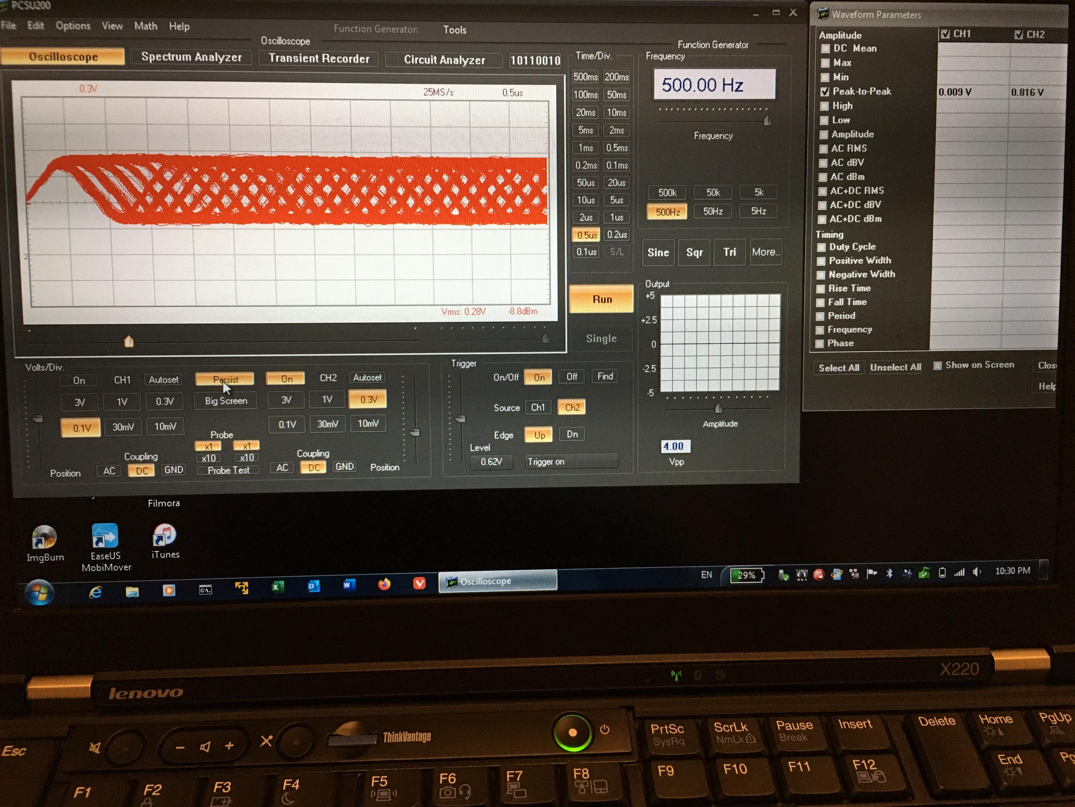

How do you enable the eye pattern on your scope when the probe is connected to the CD player RF test point?
Is there a specific setting you enable on the scope for that?

Try with the following settings as a start:
Vertical: 0.2V/div
Horizontal: 1 us/dev
Input coupling: AC
Trigger: internal, search for a relative stable pattern with trig position knob
Vertical: 0.2V/div
Input coupling: AC

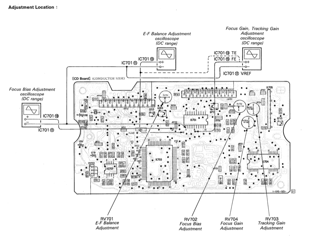

For my Teac VRDS-10, Teac writes:
"Connect the oscilloscope between TP1 (test point 1), pin 5 (RF) and TP1 pin 6 (gnd - ground). In the play mode and adjust V402 (Fbal) so that the waveform becomes maximum".
In this description there are some lackings, if you are a beginner and don't know what it is all about. For example there's a hint in the parenthese "(RF)" as to this pattern being the RF-pattern, also described as adjusting Focus Balance.
The next hint is in the description "In the play mode...". This would indicate that you need to actually play a cd.
There are however no mention of the cd type in this particular section (section 4-1-4 in the Teac VRDs-10 Service Manual), but there is a mentioning of a test cd in a later section(-s).
And that is the Sony YEDS-18 test cd, on which there are many tracks. So which one? Hmm... No description either. But in another service manual for say the Sony CBP-XB720, the same procedure is described a bit differently:

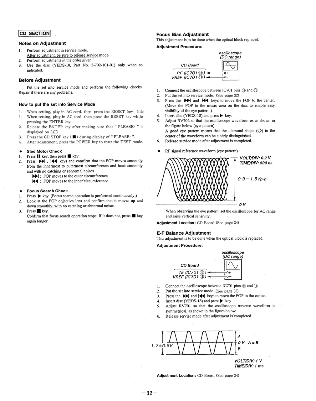

"Procedure :
1. Connect oscilloscope to test point TP (RF) on BD board.
2. Turn ON the power.
3. Put disc (YEDS-18) in to play the number five track.
4. Confirm that oscilloscope waveform is clear and check RF signal level is correct or not.
Note:
A clear RF signal waveform means that the shape “◊” can be clearly
distinguished at the center of the waveform".
Then, there is an interesting information:
"VOLT/DIV : 200mV
TIME/DIV : 500ns
level : 1.2 ± 0.2 Vp-p"
together with a picture of very general type of the RF wave pattern.
This is interesting as it will give a hint of which level you have to have it between and if it's out or dying or any other problems.
Also, in the "note", there is a brief description of how the waveform should display itself when being at it's best: the diamond shape should be clearly displayed at it's center.
On other sites and other manuals, it is also advised to adjust the diamond shaped RF pattern to be as clear and distinguishable as possible, while being within a certain voltage.

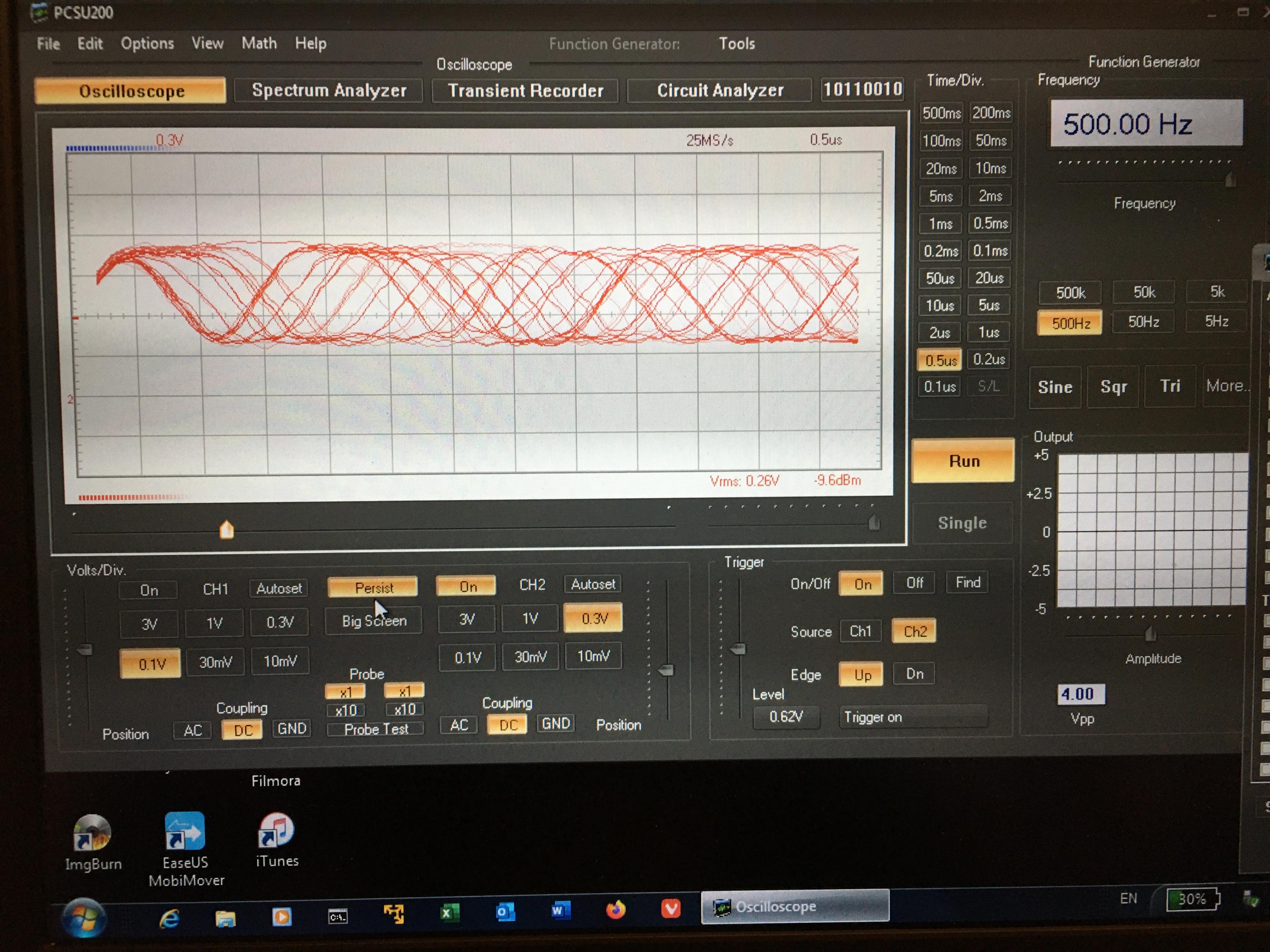

On my scope, which is as mentioned in the above, a digital one, I get the eye pattern okay'ish, but with some disturbances. There may be many reasons for that. I played around with the cables inside my cd-player, and found that pushing one particular cable, got me a clearer picture.
Also, my scope, when turned on, and showing this, I set the vertical units by chance to fill out the pattern (net guide lines), but not the whole screen, both vertically, and horizontally. Mostly vertically. That would make the diamond shaped eye pattern on my scope most like the one shown in service manuals. It did this by itself.
If I press the "auto" button on my scope, it does the same.

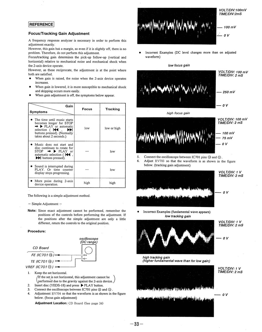

On a Sony hcd-xb44, there is a similar description for adjusting the RF waveform. This time round, the voltage readout on the scope from top to Bottom, should be 1,3 +/- 0,3v/div. and the setting of the scope should be Volt/Div: 200mV and Time/Div: 500ns.
On another player, Sony cdp-x400 and 450 service manual, there is a clear mentioning of playing track 5 on YEDS-18 for reading the RF wave pattern and adjusting.
Then set the scope on volt/div to 200mV and the time/div to 500nS. The max RF level should be 1,2 Volt +0,25/-0,3 Volt, peak-peak.
Again, I did have the same eye pattern with playing a normal music cd, but I may have wrong numbers as a result. I am now ordering the YEDS-18 test cd, and possibly get an old scope with 100Mhz bandwidth or more. We'll see.

Yes, as it appears in my Sony boombox service manual, Focus bias is the adjustment that is done using the eye-pattern and while the probe is connected to the "RF" test point.
Here the other 2 pages of the service manual I'm talking about, which describe all those 4 adjustments how-to:
And...i was wrong, opportunity to learn from my mistakes at the very least...
My el-cheapo pc based digital scope can display the eye pattern sure enough.
I just had to push that "persist" button which was before my eyes since days now...
So i just need to figure out how to get a cleaner signal now.
First photo is using infinite persistence and second photo is using variable persistence.
I just used one of my audio CDs for the test.
