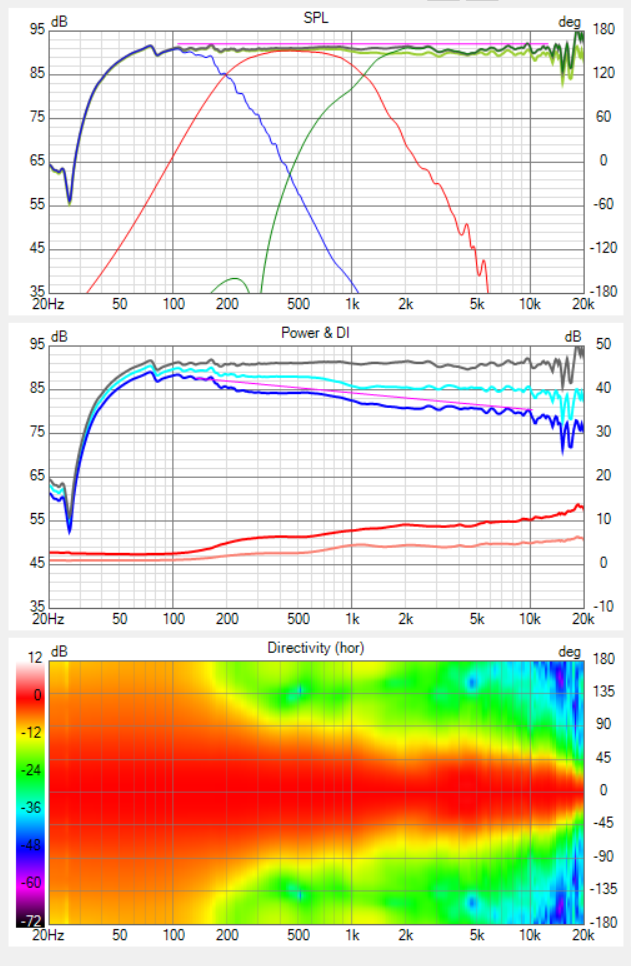

once you get it the crossovers are a breeze.
Wow, sounds amazing.
True, and it truly is! here is an example, I've got no idea what the slopes and frequencies are and I don't even have to, the devices are chosen to play together and they seem to. The info is readable from the graphs so I know what they ended up but this is what the system wanted, not what I wanted or think they should be.
Took maybe half an hour to tweak the xo but of course the measurements took maybe half a day with the setup and all. The point is not to show of, I don't know if my measurements are error free for example. The point is the crossovers are no mystery, a breeze, no problemo, a mere task to tune but not an obstacle. It takes another half hour to tweak for other slopes or "styles" of crossovers if one wants to compare how they sound like. Only obstacle is to get the acoustic design work together, and it is seen in the graphs if it does or not and it can be reasoned what needs to be changed if one wishes to improve on something.
Am I enthusiastic? yes I am but it is only because this is something very powerful for any speaker designer, especially us hobbyists, and is almost free (the mic and possibly an audio interface). And sounds better than ever, but I don't have anything expensive to compare to so absolute performance could still be poop. I just don't count it on the crossover anymore, it is the drivers or wrong system for the application if the sound is not nice. The knowledge and attention should be put on the stuff affecting in the acoustic domain and it is now possible since more brain power is freed from the crossover stuff since it is trivial with the free software tools.
