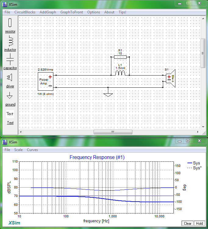

If measurement you have is good enough and can be saved as frd-file there is possibility tune precise component values over in free XSim, below example show how perfect flat frq/phase driver S1 will look when adding components R1 and L1, grey curves is components bypassed and blue curves is within those values shown. So if you doubleclick S1 driver and load your measurement in that dialog menu frq response will reflect your measurement and you can thereafter sweep component values up and down in value until frq response suits best your situation.
XSim is to find here: http://www.diyaudio.com/forums/software-tools/259865-xsim-free-crossover-designer.html
