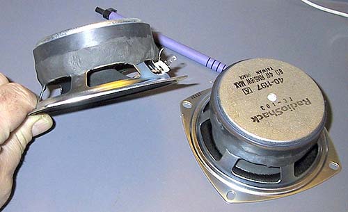

what do you mean by "ductsealing the baskets?"
Do a search for some comments.... here is one.
http://www.diyaudio.com/forums/showthread.php?s=&threadid=23468&highlight=
An example of a ductsealed driver... the mids & tweeters will also benefit.
dave

so sealing the space between the mag and the basket is ductsealing? I'm not going to build cabs right away ( oak is expensive ) so I'd like to try bracing and dampening these. Its good practice I guess and I may just buy new drivers for my new cabs and sell the marantzes.
The Ductseal damps basket resonances, so unlike the 4 which has no basket legs you would put some on the legs as well. You also use it to make the shape of the basket streamlined.
Another example (12" Philips) attached. These have also been puzzlecoated. Used as subs the streamlining was less important
