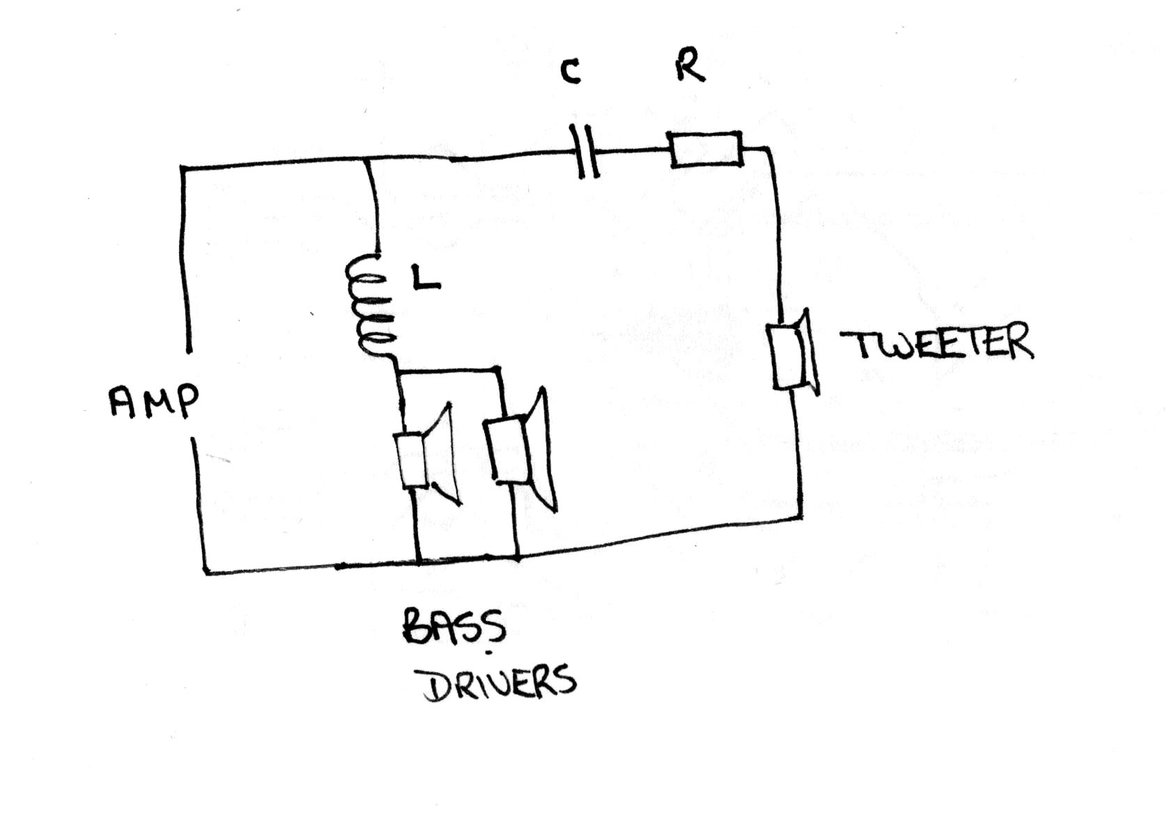

hello im a novice to sound systems and I am building my first. ive got a lot of it sorted but stuck with some speakers im building.
im going to be using four 8ohms drivers that run at 50watt rms each. with each driver will be a "Piezo Horn Tweeter" 60 to 80 ohms 150watt max.
now I don't no how to wire these up or what size amp to use, I was thinking of using a 500watt 4ohm 2 channel amp will wireing all these speakers up to 2 channels cause the ohms to get to high for the amp? do I need to use a passive crossover with each speaker? I will be using a active crossover anyway but like I said im a novice.
any help would be great 🙂

Each of your Full Range drivers can ONLY handle 50W each, so irrelevant of how they are wired up, the maximum that four can handle is 200W.
4 x 8 Ohm drivers can't be wired to provide a 4 Ohm load.

You need to specify what power is being fed to which channel.
An amplifier is "usually" specified with Watts/Channel. However, car audio manufacturers often bend the rules to make their equipment look more powerful than it actually is.
You cannot just add the power of all the speakers together and feed them with that amount of power.
Although not strictly true (because different drivers have different sensitivities), each driver (ie bass and tweeter) will be fed with the same power, just at different frequencies.
So if you have 50W Bass drivers, two in series or parallel will be able to take 100W MAX.
So the Tweeter will also be fed with the same 100W.
Often the Tweeter is more sensitive than the Bass driver (often about 3dB more sensitive). In this case the Bass would be fed with 100W and the Tweeter attenuated to 10W in order to maintain linearity throughout the audio band.

In which case your drivers are ALL too low a power.
The amp will FRY all of them.
The MAXIMUM amp that you can use with the drivers is 100W/Channel and that is if you use two bass drivers per channel.

Let us consider this very simple crossover.
At very low frequencies the reactance of the capacitor is very high and that of the inductor is very low. Therefore low frequencies will pass through the two bass drivers. As they are in parallel each can dissipate 50W so the maximum amplifier power is 100W.
At high (for audio) frequencies the reactance of the capacitor is low and that of the inductor is high. Therefore high frequencies will pass through the tweeter.
If the sensitivity of the tweeter is higher than that of the bass drivers (which is common), if R wasn't included the speaker would sound VERY bright and would be horrible to listen to. R is included to attenuate the high frequency signals to the tweeter to dull it down a bit.
You can see that it makes no difference if the tweeter is 150W, the bass drivers still have to cope with the full amplifier power.
This is a simplistic crossover, there is a bit more to them that I have detailed above, but my explanation holds true.
