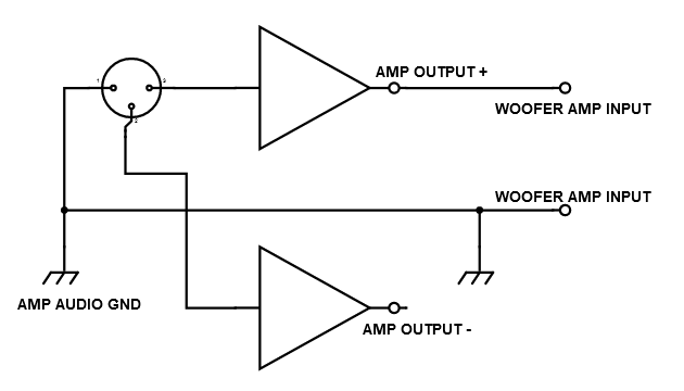

I just got a pair of Icepower 300ASC-based mono amps (Emotiva PA-1) which are fully balanced (input to output).
My speakers are a three way with 6" woofer and tweeter passively crossed over, but the 8" lower woofer has an active amp and crossover.
Previously, I'd connect both the upper passive driver binding posts along with the woofer amps high-level input to my amp terminals (the woofer amps also have a single rca input).
However, the new amps' manual says DO NOT connect the balanced outputs to a device with a common ground.
Anyone familiar with a solution for this(that doesn't require replacing or redesign of the current speaker/woofer amp.

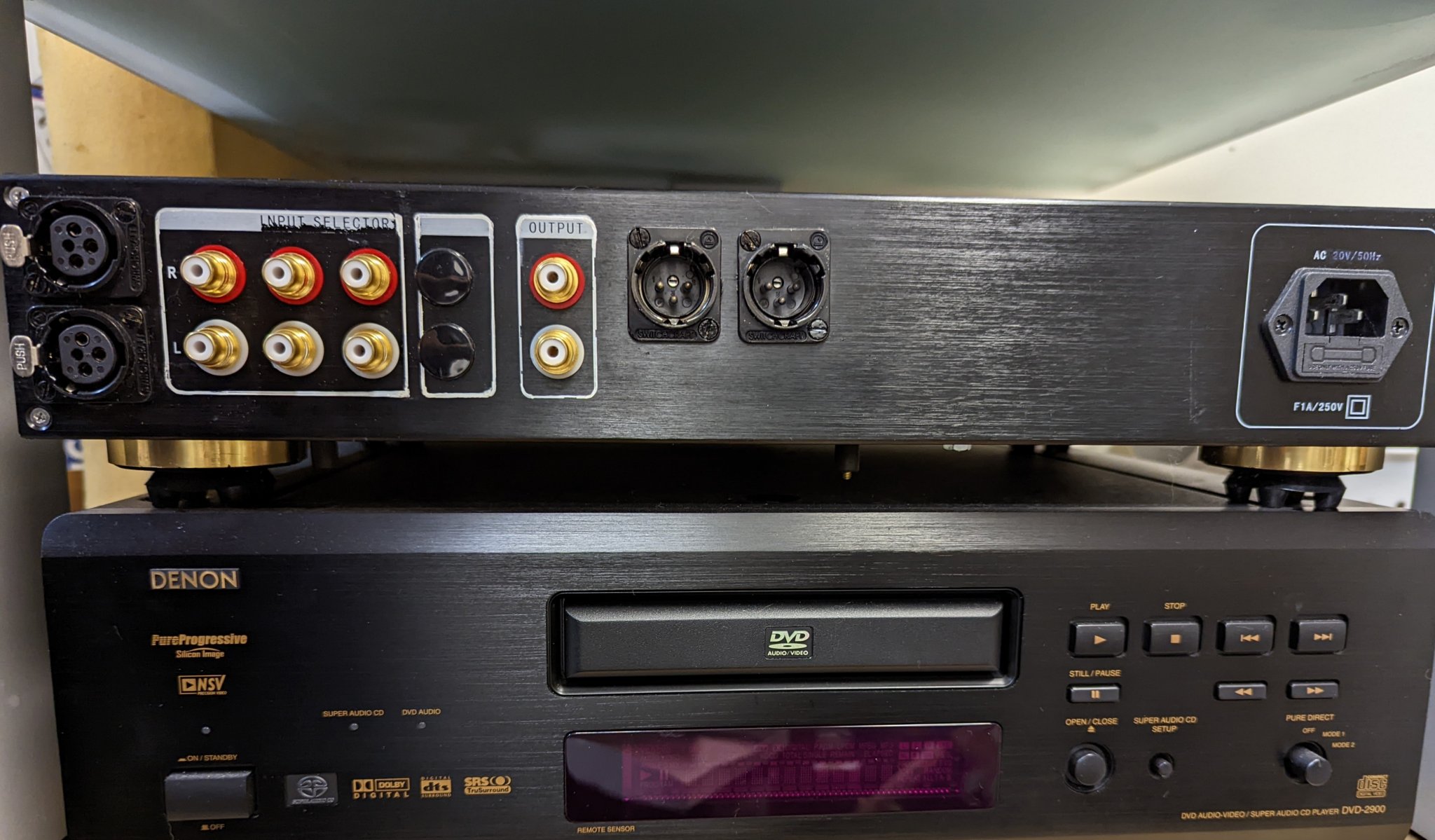

It's a DIY unit based upon the Pass B1 buffer. I have it set up in differential mode through balanced XLR output. To restore to the rca single ended outs again I'd have to rewire it :-( (unless there a way to switch between the two modes?). Any suggestions?
Another way to try is connect the woofer amp high level input+ to Emotiva PA-1 speaker terminal+, DO NOT connect the woofer amp high level input - to Emotiva PA-1 speaker terminal -, connect it to the Emotiva PA-1 audio ground instead.
