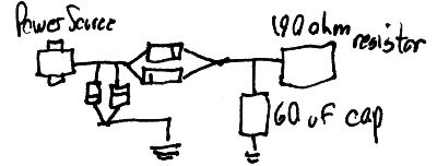

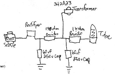

Here is a rough diagram showing the current circuit layout including the selenium rectifier.
This drawing of mine shows just the stuff going from the power supply > the selenium rectifier > to the tube.
My understanding on how to do this
Here is my understanding on how these are to be soldered in place of the selenium rectifier.
Remove the selenium rectifier.
Solder in its place one diode with the cathode in one direction and another with the cathode in the other.
At the power source end I solder one diode with the cathode in one direction and another with the cathode in the other. The opposite ends of each solder to ground.
Is this correct?

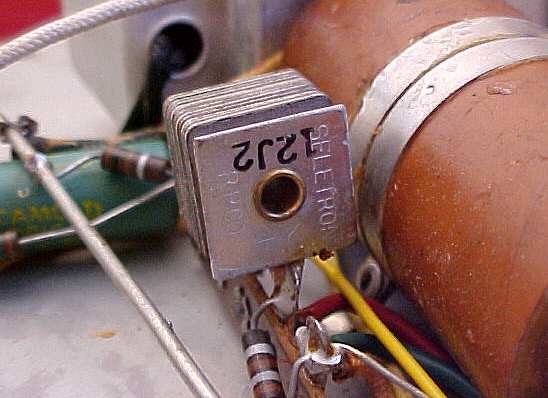

Here is the problem. There isn't a "+" on the old recitifier. Attached is a close up.

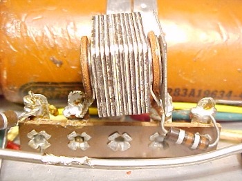

here attached is a close up of the recitifer showing the end that factes the tube side of the circuit.
I just looked it over and this is the side of the "+." Barely noticable in the scans, however.
It looks from your photo like it's just a two terminal device, i.e., a half-wave rectifier. So all you need is one of the silicon diodes to replace it. The earlier discussion with planet 10 involved using 4 diodes for a redesign/rebuild of that supply. You can do that, but given where you are at the moment, I'd just do the one-for-one swap, get the thing working, and save the other 3 diodes for when you're ready to take the next step to a full-wave bridge.
