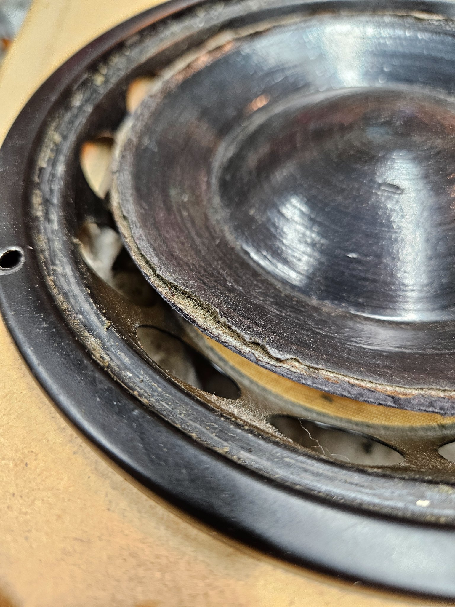

I have several small "woofers" to refoam that have a paper cone coated with a softer, slightly tacky layer. I've peeled away the rotted foam but it leaves a very narrow edge of exposed paper, with a slight 'lip' where the coating starts that I think would interfere with the new adhesive. If I try to expose more paper it tends to want to peel off too much. Abrading the coating only damages the paper beneath.
What's the correct technique?

This is where I'm at today.
The coating was applied over the edge of the old foam so when that was pulled up it left the tattered edge of coating pulled up, with ~4mm margin of exposed paper.
The cone is straight-sided...i will need to use a surround with an angled edge. And I may have to cut the surround to 'shrink' it to the correct diameter for this metric driver.

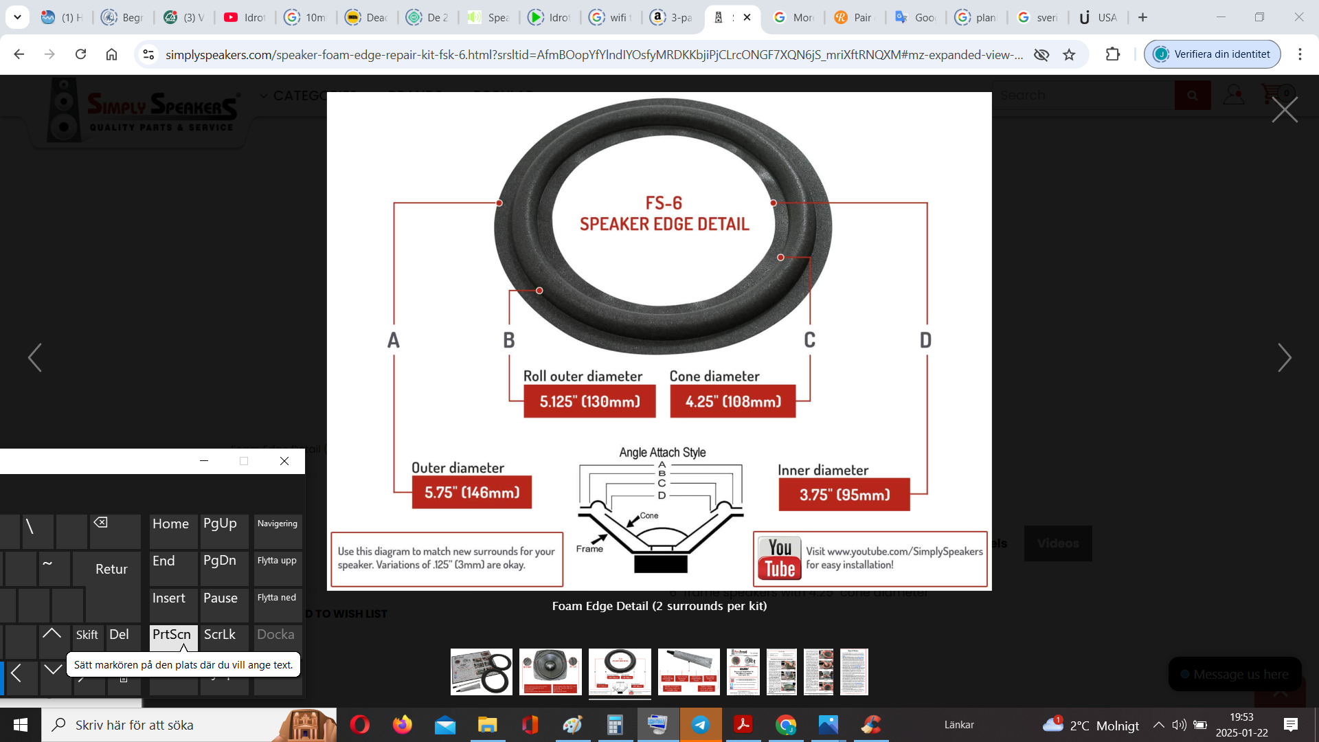

I had a look on another Morel MW-160.
Quite gigantic surround!

From your initial photo the treatment is not applied consistently over the foam edge, therefore this isn’t critical (or wasn’t well done originally).
I think trimming off the overlapping and now essentially useless treatment, to leave a consistent and fairly flat adhesion area, is the way to go. This may require tedious gentle pulling with pliers or tweezers and simultaneous cutting with a sharp blade or trimmer like a small carving tool. The cutting should prevent removal from the cone where the treatment should remain, obviously with care to not do damage and hopefully with nice aesthetics.

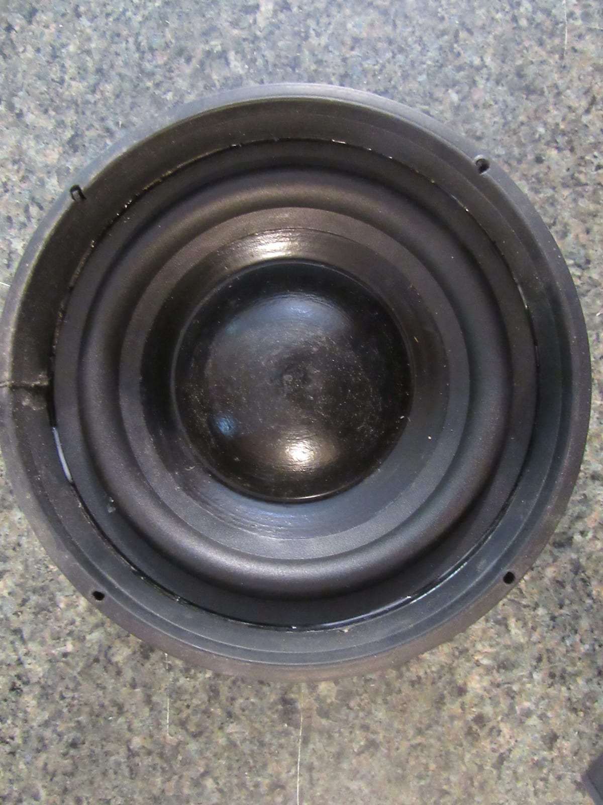

It looks like a rubber surround put on later...Is the driver in post 8 original or has it been refoamed?
It looks nothing like an original unrotted foam (#10 - a scan of a film photo I took ~35 years ago). I'm sure it's been replaced.

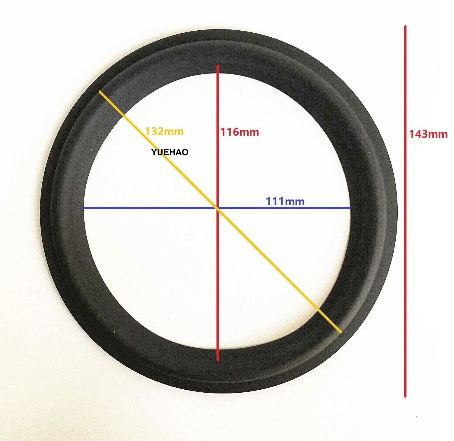

I'd sure prefer a narrow replacement if I can find one. Sellers don't make it easy.
Pricing is all over the place from $1.24 ea to over $15 ea.

I read that Morel MW-160s become Morel MW-164s, with the rubber surround.It looks like a rubber surround put on later
I don't think Morel could produce something as unappealing as that refoamed unit.
