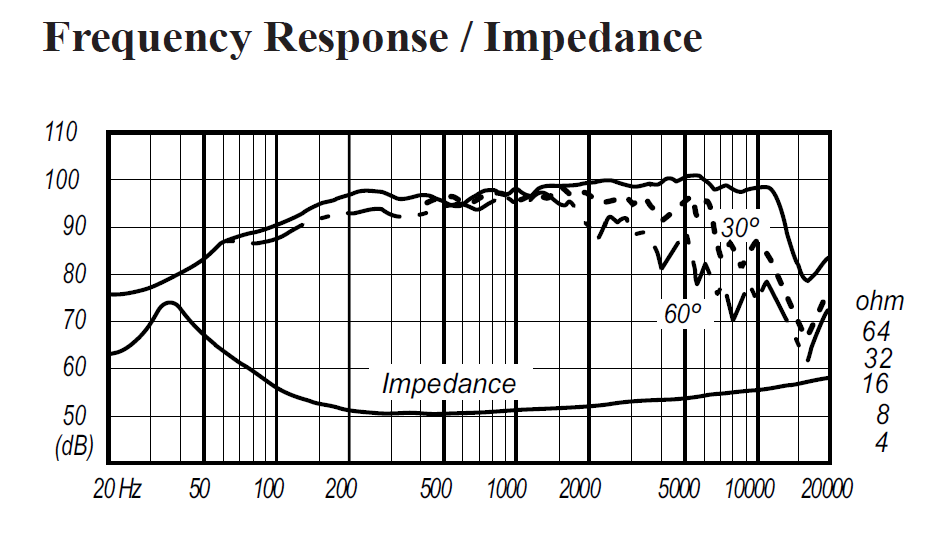

Hi All, I am thinking about a office system and want to get back to full range. I looked at the Fostex FF225 and see that it starts it's roll off at 200hz or so. Will that area below 200hz be boosted by the cabinet, or will I need subs?
Fostex tests their drivers on an EIC standard baffle -- it's an OB response. Most manufactures do this, Seas being one exception that comes to mind. Basically, published FR curves are useless for estimating bass response in an consumer baffle.

Thanks Bob, that is good to know. I assume that is why the graph shows a certin rolloff but the Fs is much lower.

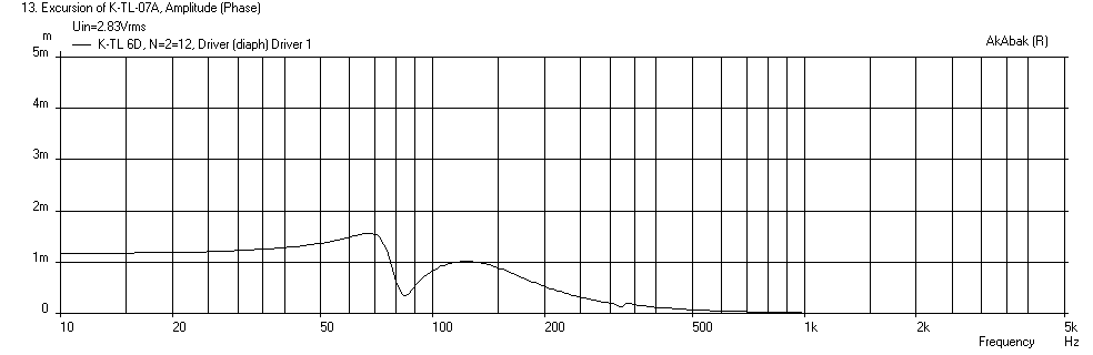

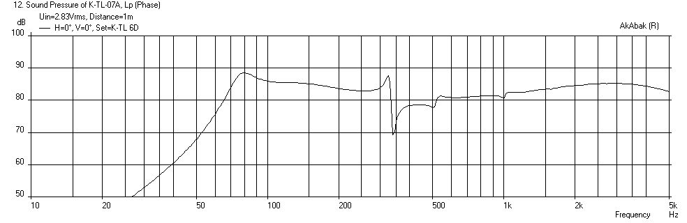

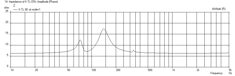

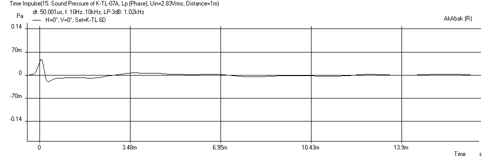

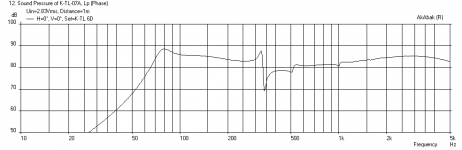

If you want to go with a cute single Vifa Karlsonator at 0.4x scale (12 in tall x 6.1 in wide), it can work, albeit with only 85 dB efficiency and bass extension is down to about 80 Hz which is not bad for a desktop computer speaker.
Here are the predicted (walls far away) Freq Response, Impedance, Cone Displacement, and Impusle for a single Vifa in a 0.4X Karlsonator. Looks pretty good actually.
