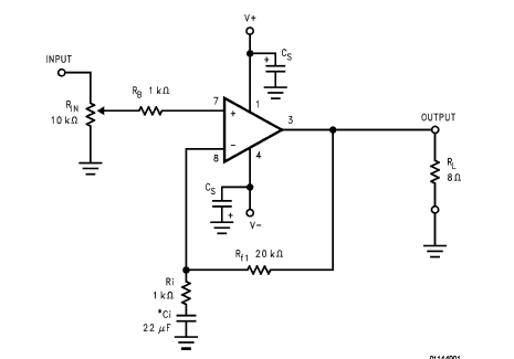

Hi i have build a gainclone as must of you know. I have measured the dc offset i get around 89mv. The setup is stereo gainclone with caps at rectifer bridge board which are 2 per rail one is elna 50v 3.3 and one is 50v 10uf panasonic. The ch is connected to the ground for both channels . pg- and pg + are connected to the sg on both amp boards to ground them. I do not use volume pot i connect the input wire straight to the output of my pc sound card.

1. 89 mV ( 0.089 Volt DC ) is not very big offset.
It is one you can live with. But we do not wish to have close to 0.1 Volt
2. See attachment. Typical non-inverted LM3875 circuit.
it is taken from The Datasheet
http://www.national.com/ds.cgi/LM/LM3875.pdf
3. The cap *Ci = 22 uF is to block DC feedback to GND.
When using Ci, we can often get close to 0.0 Volt offset.
4. When NOT using Ci, then we can get such DC-offset at Output.
To remove this offset is not so simple as only use 1 resistor.
There are several ways to fix the offset when not using capacitor Ci.
But simplest way is to ad a very good quality capacitor.
There are good electrolytic:
22, 47, 100 or even 220 uF may work.
regards

joka22 said:how do i lower my dc offset 89mv
The simplest way is to change the value of R2 from 22k to 10k.
this will lower the gain to about 50%

By R2 I mean input shunt resistor: http://www.diyaudio.com/forums/attachment.php?s=&postid=1508778&stamp=1210693738
Kudos Peter! That works like a charm. 😉

I would not avoid to use Ci capacitor.
National techniqal lab workers recommend this for low offset.
And through the history of audio
we have had so many good and even superb power amplifiers using DC gain = 1 + blocking caps.
AC blocking caps arefound most everywhere in good proper audio.
Input, output, feedback.
If you design your amplifier per sibjective listening test,
you will get a subjective result.
Which is not necessarily the good/best amplifier.
