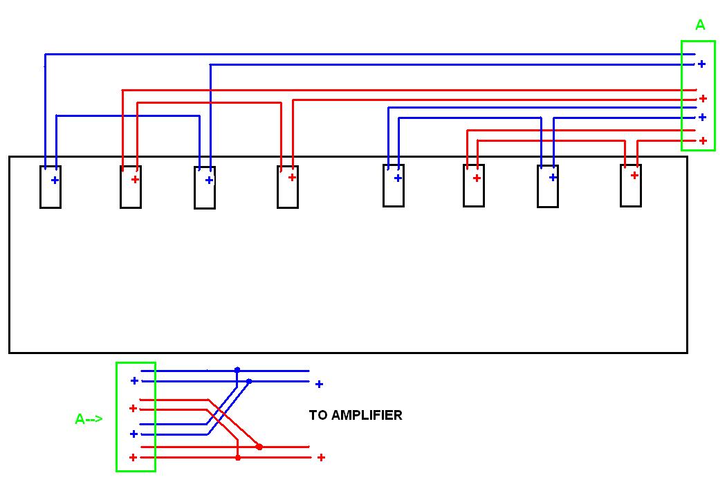

1) you can not run 5 pairs of speakers in *parallel*.
why? the impedance will drop too low (below 4 ohms) and cause
excessive power draw, likely blowing the fuses or worse, smoking the amplifier(s).
2) if you run them in series the impedance will be too high, and the level per speaker too low.
3) also, if all speakers are not *identical* then you are likely to get "power hogging" and strange loads which can either blow speakers or amplifiers.
In terms of possible wiring and connections, an even number is generally easier to use assuming some sort of series/parallel wiring combination. This permits the sharing of power evenly and at the same time maintaining the impedance the amplifier sees above some reasonable value.
An example of series parallel, for 4 speakers would be (speakers E, F, G, H) E & F wired in series, G and H wired in series, now both sets E-F & G-H then wired in parallel. The original impedance is maintained. You do get some acoustical power gain too (it plays louder for the same power input).
Clearly, this is not possible with an odd number of speakers.

ok so if i just use 4 pairs of speakers would it work to wire 4 speakers in series parallel to one channel and the other 4 to the other channel? also would i need a selector switch if i did that?
