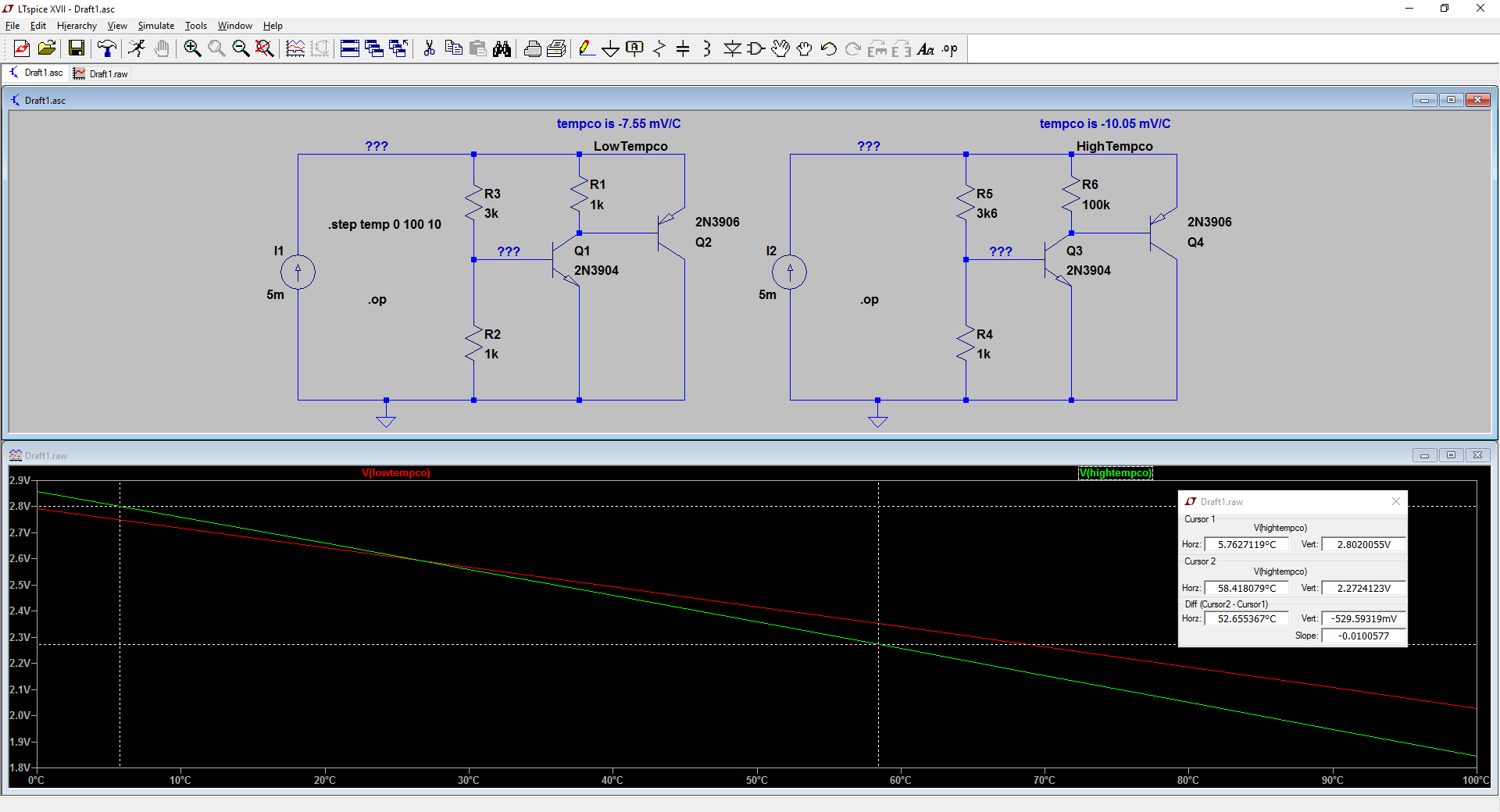

You can adjust the tempco of a Vbe multiplier by changing the current that runs through the first transistor. In the case shown here, going from R1=1K on the left ot R6=100K on the right. There are two factors at work:
1. the tempco of Vbe=(Vbe-Vgo)/T (Vgo is the bandgap voltage of silicon, about 1.21 volts, T is temp in Kelvin), so a transistor operating at lower current, and hence lower Vbe has a more negative tempco.
2. To make up for that lower Vbe, and make both circuits have the same voltage at around 25C, we need to increase the multiplier ratio (R3/R2 or R5/R4), which also increases the tempco
The result is that the circuit on the left has -7.55 mV/C, and on the right we have -10.05 mV/C.
That difference is pretty large...over a 20C change, that makes a (10.05-7.55)*20=50 mV difference. Across the typical 0.54 Ohms of total emitter resistance (0.27+0.27), that current difference would be 50 mV/0.54 Ohms = 92.6 mA in quiescent current.
