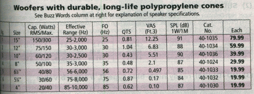

The above posts are excellent about measuring your own Thiele-Small specs.
However, here are the published specs from the Radio Shack 2002 catalog. The 40-1035 is the first woofer listed. Fo equals Fs, the speaker's free air resonance frequency.
thank you
although i have little knowledge of using programs and software to reach an enclosure size.
with the info given on the catalog page.
any guess what a best/decent sized box would be for this driver ?
i can make any box once i know size and sealed/ported rec. and port dia and length.

Zuki:
The high Qts of 0.81 pretty much rules out any boxes, except under special circumstances.
Many people here are building dipoles, for which this would be an excellent candidate. A dipole is a large board, not a box, with a speaker simply mounted on it. However, there are special dipoles which sort of snake the board around angles. These are called folded dipoles. Many people here are building these. If nobody posts here about them, I suggest you start a new thread about using one of them for your woofer.
You wouldn't have a closet door you can mount this on, would you? That is would be a great way to use these.
Another alternative would be to mount in a large sealed box, which would give you a large hump in the response. Then apply something called a Linkwitz Transform to take the hump out. The Transform circuit is something that many people are building here also.
Those seem to be your choices: Put into the door of your closet or on a wall to another room, build a folded diple enclosure, or use a Linkwitz Trasform circuit. I have never used a Linkwitz Transform circuit, but I know they are capable of taking a box with a speaker of too high a Qts and making it work.
