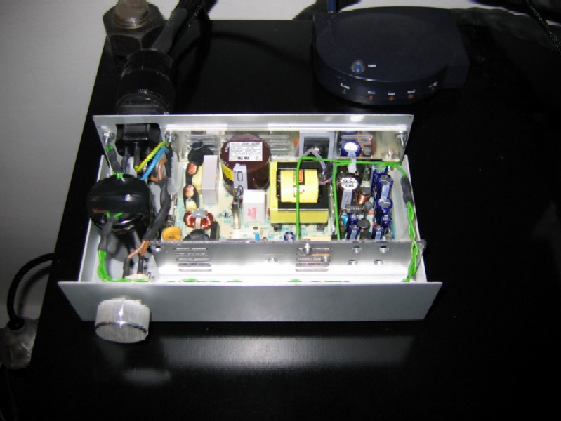

I've got one of NUUK's Skynet 8080 SMPS for my T-amp. I need to box it to stop the kids poking their fingers in and getting a shock (!)
I'm thinking of using a Maplin aluminimum diecast box because its robust, and it will keep in some of the switching RF. However, I am concerned about where all the heat is going to go in a sealed box.
Has anyone boxed a Skynet 8080 ? If so I'd be very interested in you experience.
Should I drill holes in the box to let the heat out ? How big do the holes have to be before they let too much of the RF out as well ?!
Should the box be on the end of a long wire to keep the nasties away from the T-amp, or can it sit on the shelf next to the T-amp, and enjoy the benefits of a short power cable ? Pros & cons ?
Finally, what sort of DC plug and socket should I use on the T-amp ?

dont worry about the heat, it's a T-amp and it's gonna need a lot of abuse to get to that level!
Pop a few drill holes in the base plate to get some convection currents flowing but dont worry about RF as it will be absorbed by the case dispite the holes.
My PSU is in the same case as the T-board and there is no interference at all, as long as there is some kind of earthed metal wall between them.....I think his may be overkill as well!

Did you use one of NUUK's Skynet 8080 SMPS and put a 10 ohm 10Watt resistor across the 5V outputs as he recommends ? It gets too hot to touch !

I've mountd Nuuks Psu in an aluminium case bought from Rapid electronics.The resistor I've mounted on the SMPS enclosure there are some holes that the resistor can be fixed to
Input is via IEC to a on/off switch.O/P is via 2.1mm DC socket from Maplins

Used a Maplin alloy box and a 10 ohm 10 watt resistor as per Nuuk's instruction with a pair of 10,000 mf caps.
Yes the resistor gets hot, but well within it's operating limits.
The box I used was well oversized and I have not drilled any ventilation holes, it stays within sensible temperature level and barely gets warm.

I hope you did not attach the resistor to the caps. This would heat the caps up enough to be a potential problem. I would recommend remote mounting it against the chassis to dissipate the heat and use additional wire to couple it into the circuit.

Using the box as the heat sink for both the SMPS and the resistor is a good idea. Plaited cables look impressive too !
Anyone tried heat sink paste on a ceramic resistor to improve the heat transfer ?!
BTW Kasumi - where did you get such a huge IEC connector ? Presumably you've got shielded mains cable ?
