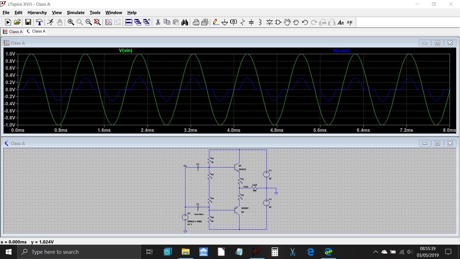

Just so that it all makes a bit more sense......
In the above example we have no DC bias voltage between the base of the output transistors and this in turn means the input signal has to overcome the 0.6 volts B-E turn on voltage before anything happens.
That is a bit unrealistic and is the reason for the apparently low amplitude of the basic Class B example when supplied with only 1 volt peak of signal.
If we make the bias voltage variable (the resistor bias chain is now a voltage source which makes it easier to follow and work with) we can increase this bias voltage right up to the point where the transistors begin to conduct. This still satisfies the Class B definition (zero bias current) but now means the transistors are now ready to conduct more readily and do not need the input signal to first have to exceed the 0.6 volts Vbe.
In other words they are biased right up to the point of begining to conduct.
So we get this (first image). Still Class B but much less distortion.

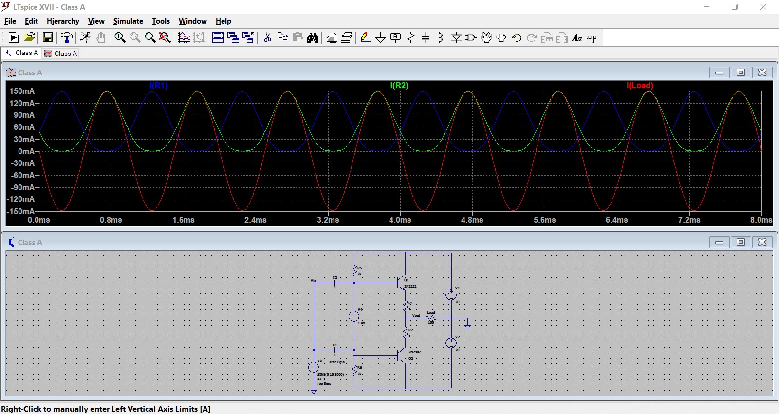

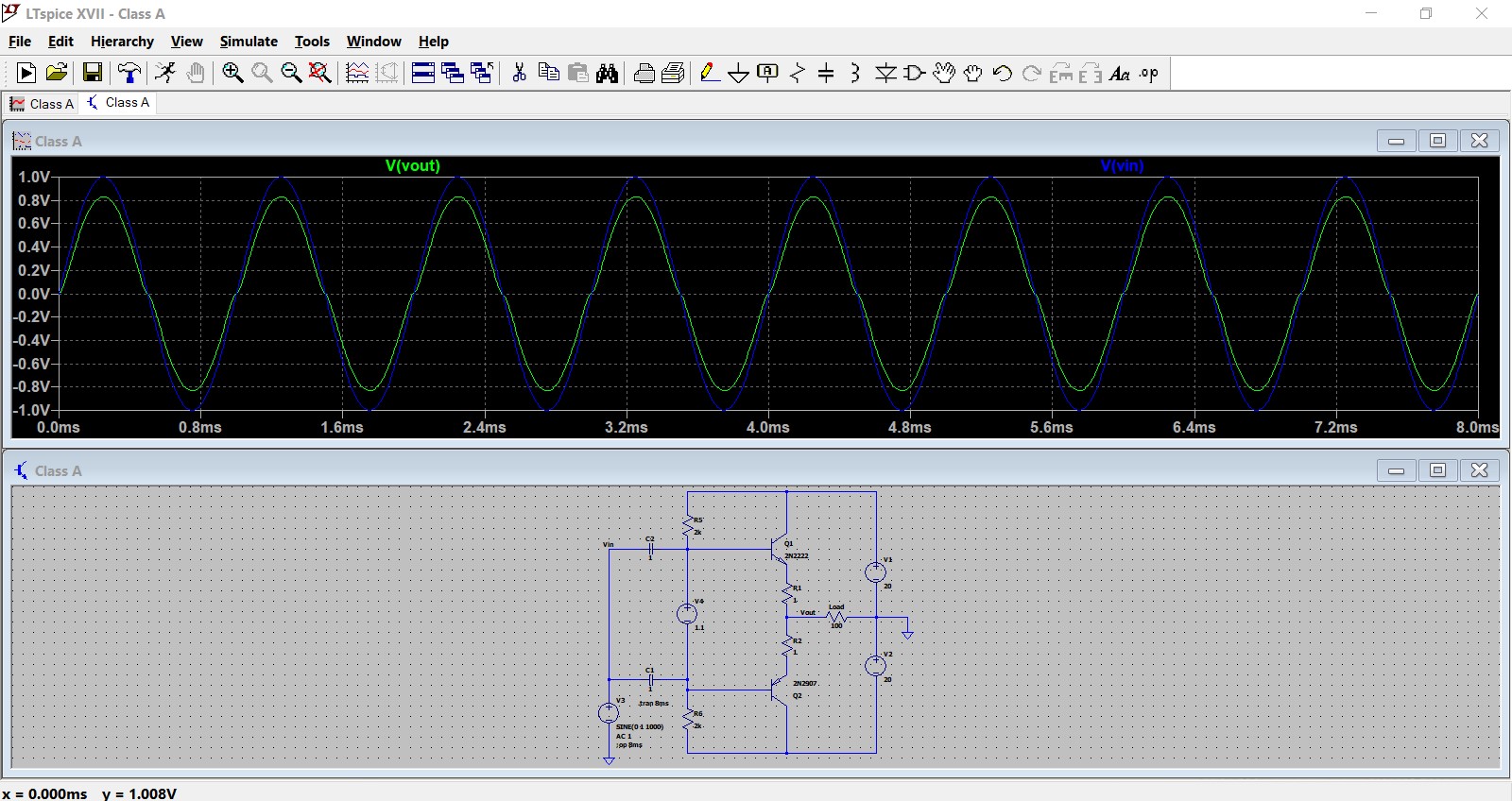

Now we move on to Class A. The input signal has been raised to 10 volts peak and the load current is now also 10 volts peak but crucially we can see that there is now 100ma peak signal flowing in the load.
What bias current do we need to ensure Class A operation? (Second image) Note... the display is now showing load current rather than output voltage.

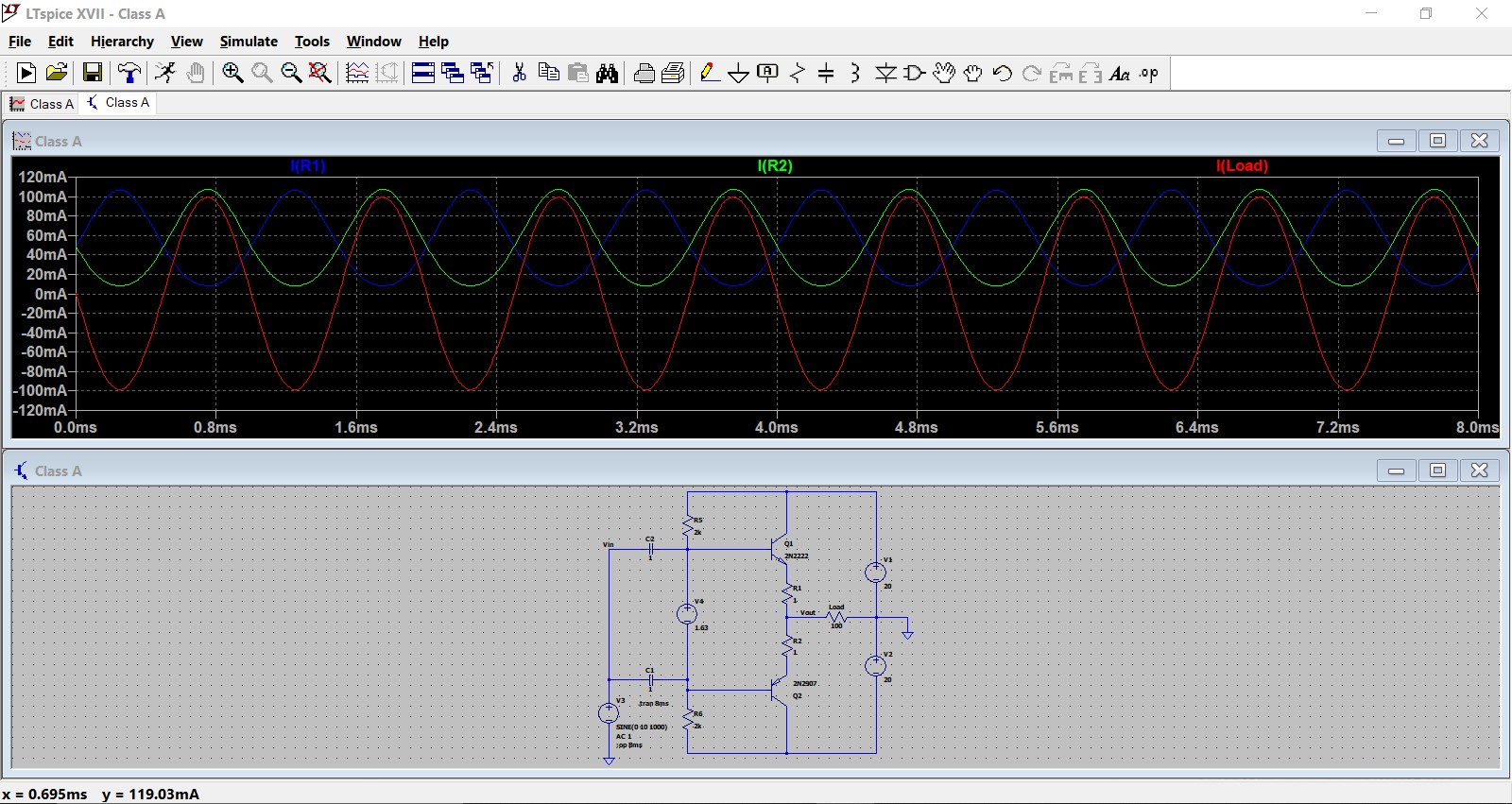

In our example, 100ma peak signal flowing in the load means that we need a static bias current of 50ma flowing in the transistors. When this occurs the current in each transistor when driving the load will vary from 0ma to twice the set bias current (100ma). So neither transistor is cut off at any point (it is in Class A) and it can supply the required load current in this 'always conducting' state. This is seen by looking at the currents in R1 and R2, the 1 ohm resistors.
The third image shows the effect of increasing the signal to 15 volts. Now we have 150ma peak current in the load but the transistors are now being forced into their 'cut off' region where each becomes non conducting over part of the cycle. At this point the stage has moved from Class A to what many would call 'overbiased' Class AB operation.

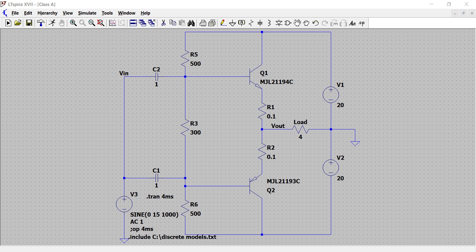

Mooly,
so for an anticipated max 4 amps load current the transistors should be biased to continuously conduct 2 amps each?
This can be achieved via the voltage bias chain?
Correct?

Four amps delivery would be to much for such a simple single transistor pair to work with. Yes, you could bias them to this value but the base current needed would be so large that the overall input impedance would be very low and unpredicatable and the overall performance totally unacceptable. You would need a small power amp to drive the signal into them 🙂
So you would need a different approach such as incorporating driver transistors and then wrapping feedback around them in the form of a more conventional set up.
It all depends on what you want really. A stage like this runs totally open loop with no overall feedback and that makes the performance very poor... even though its still Class A.
I tried it for interest. At 2 amp bias current and 4 amps signal into a 4 ohm load the source driving it needs to deliver around 130ma peak drive current. Also look how low the input impedance is going to be with those 500 ohm resistors (so 250 effectively) plus whatever the transistors pull it down by.
Hope it makes sense. Voltage scales on the left, current on the right. The small red trace is the current drawn from the signal source driving the stage.

Your diagram is lacking the vital resistors in series with the transistor emitters; as shown the quiescent is virtually uncontrolled and there will be smoke.
You will see that Mooly has added 0.1R resistors on his simulation schematics.
In push-pull Class-A the SUM of voltages across these two emitter resistors is constant despite the current flowing in and out of the load. You can use this voltage to control the quiescent current by negative feedback, with great accuracy.
