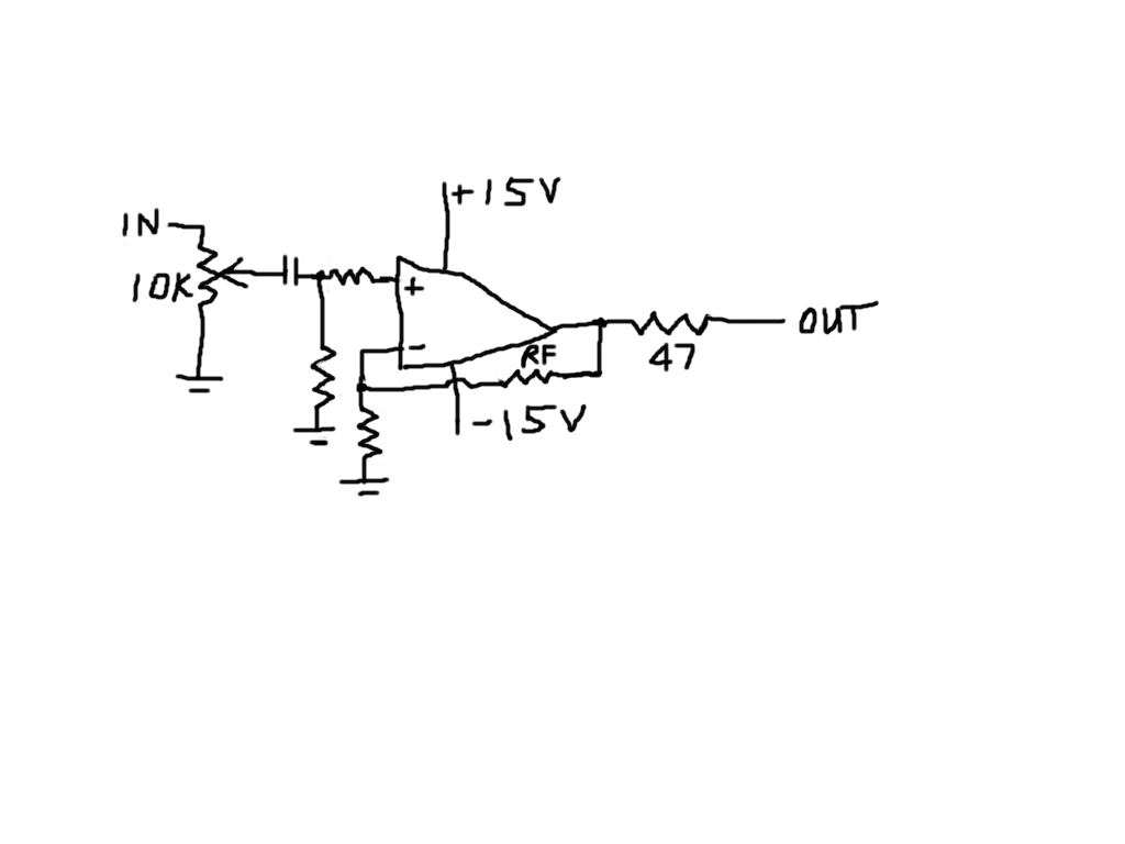

Getting back to what I'm trying to learn here...how would you modify the AD827 circuit below in order to minimize DC offset at the outputs? I put a capacitor in right after the volume pot, as barefootwhistler suggested, but not sure what value to use. I typically see smaller values like 2.2uF used.

Okay...I need to equalize the DC resistance seen by the 2 inputs and I need to add a capacitor to the feedback network.
Being there are many resistor and capacitor values, this doesn't tell me much.
How would I choose, or calculate, what resistors would be needed for a gain of only 2 using the AD827? I typically use values like 2K for both resistors, but I'm assuming these aren't going to be the correct values so that the -input resistance is the same as the + input.
Same question for the capacitor going to ground...no clue as to what value to try.

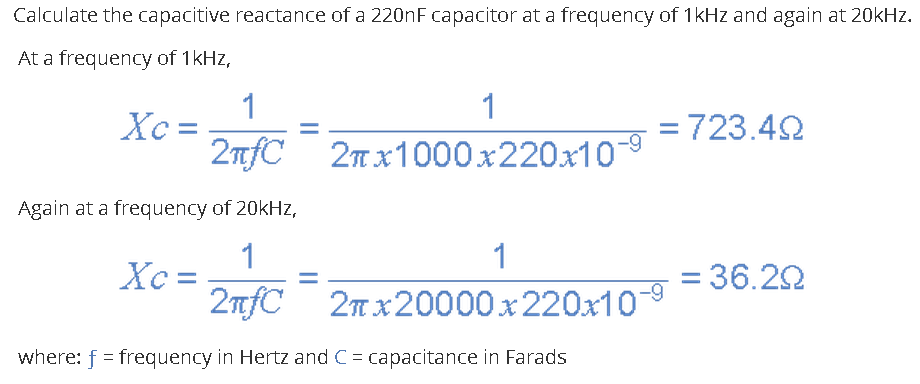

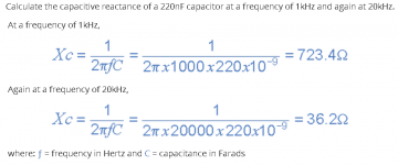

Did a quick search for R=Xc and came up with nothing. I did learn that Xc is capacitive reactance and found a formula for calculating it.
Is the formula below what you're referring to?
Your circuit in post #10
There are no hard and fast rules... you need to decide on the midand gain you want. Lets say you want a voltage gain of 15.
The gain is (Rf+Rg)/Rg and so you need resistors in a 14:1 ratio. i.e. if Rf were 14 ohms then Rg would be 1 ohm.
So what are suitable values. Typically we would set Rf at the 10k to 30k region. Any higher and noise contribution might start to become significant. Go lower and the opamp has to work harder to drive the feedback network and distortion rises.
So its a compromise that depends much on the opamp used.
Lets say we use a 10k. That means Rg has to be 714 ohms. We would use 680 as a nearest preferred value.
What about the cap in series with Rg. You decide the -3db point you want the amp to roll off at. Lets say 2Hz. With a 714 ohm resistor that means you need a 110uf cap. That would ensure the response was 3db down at 2Hz.
The resistor you have shown as 100k on the input needs to match Rf for minimum DC offset. This is because for bipolar opamps a steady DC bias current either flows out of or into the opamp input pin from ground. That current develops a volt drop across the 100k which causes the DC offset when the voltage at the other input pin is unequal. So to equalise them, Rf and the input bias resistor need to be the same value.
Use a FET opamp with essentially zero DC input bias current and the offset problem vanishes.
The input cap is chosen in the same way as the feedback cap. You then have two filter networks in the chain and the actual -3db point would shift from 2Hz to nearer 3Hz with the combined effect of both networks acting on the amp.
Does that help ?
Barefoot gave the right answer in the 2nd post.
Nigel is almost right. The capacitor and the impedance that follows it form a high pass filter. The corner frequency of the filter is dependent on both values. On a preamp output you have to deal with the reality that the load might be as little as 600 ohms, so fairly large capacitor values are often used, such as 10uf.
On the input, the resistor between the input and signal ground sets the impedance, so you just do the math or use a calculator for a corner frequency below 20hz or so.
I'm not sure what sreten is on about.
As for balancing the currents, Tangent's calculator page has a good calculator for that. As the input currents go up, the values of the feedback resistors have to be more carefully chosen to balance the currents, and you will probably need some fairly specific values to limit offset. you will need the opamp datasheet.
