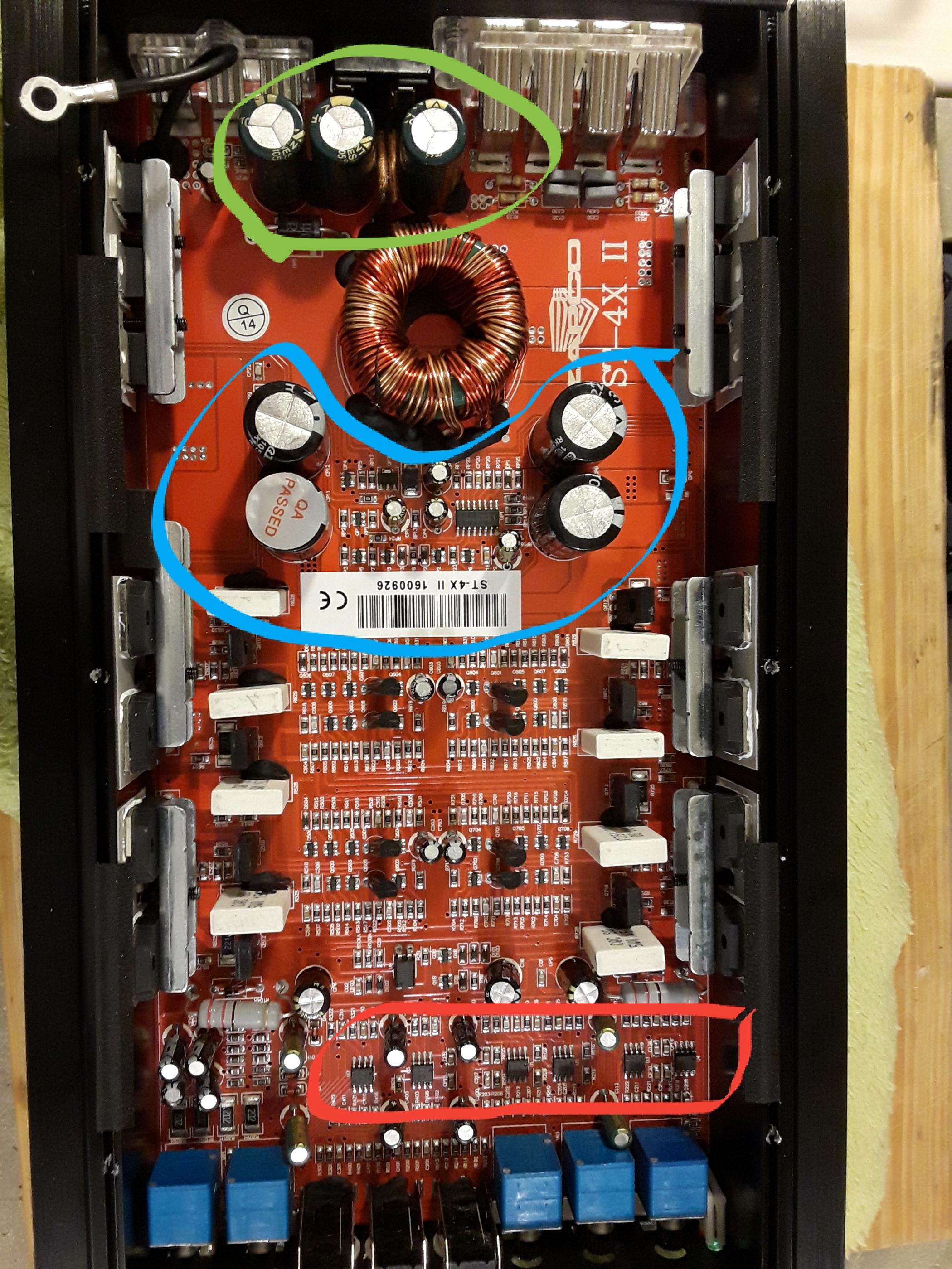

So I have been researching upgrades while modifying caps and or op amps. But I lack alot of knowledge, I want to send my amp off for modifications. Maybe upgrade caps since ones used are cheap chinese ones and this amp has 6 jrc 4558d op amps. Seems my output caps are very small and power supply caps are bigger and a mix between 2 diffirent brands. So the black ones are cheap and could probably be upgraded qhile the green ones with a ca logo supposebly are better than nichicon etc (said by manufacturer which use to use elna and nichicon before)i wqnt to acheive better sq if possible. They have an exact upgrade for this amp sq version there are very little gut pics on internet but from whatI can tell one diffirence is power supply caps are of greater uf values. I am still trying to understand this board. In pic blue circled are the cheap chinese caps (labeled gl elec international) 2200uf 35v and circled green are the supposed better than nichicons on power supply side. On other side circled red are 6 jrc4558d s. Maybe im out of my mind I know I could just buy another amp but I like to work and understand things on my own. I rather upgrade my own amp if possible rather than buying a new one it is more fulfilling to me, its a passion. Im in central florida dont know anybody who knows about these things
Virtually 100% of the 'upgrades' suggested will do NOTHING for sound quality.
Hi thank you for replying, but that does not make much sense to me. Diffirent amps have diffirent components and sound diffirent. Some cheaper amps sound worse than more expensive ones for a reason. But what do you think upgrading for power or longevity? I have seen people switch op amps out so their speakers sound more to their taste. I k ow alot of marketing is just "snake oil" to say but arent diffirent components better than others, and again tha k you for responding and not being negative appreciate your opinion I really do
If you want something that's colored, more musical, switch to tube amplifiers with an output transformer.
Op-amps use feedback and that virtually eliminates distortion. The same goes for the power amplifier stage.
The biggest problem component (by far) in your system is the speakers.
Replacing capacitors (a component that only very rarely fails unless the amp some fault -- failure of other components) does nothing.
What I love (to hate) is when people say that some mod opened up the soundstage. That would require increasing the left/right separation and unless you're using headphones, there's no way that you will hear any difference with any mod.
The only difference that you 'may' get with changing op-amps is a lower noise floor. If you have a car that's so quiet that you are going to be bothered by the background noise of an amp with properly set gains, you probably have an expensive car and amps that are of such good quality that they need no mods.

Modifying existing amplifiers to improve them is generally a waste of time, might as well start with a blank canvas and design from the ground up, or simply sell the amp you have then buy something that fits your needs. The money spent on trying to modify something that will make no improvement, could be spent buying something else.
Swapping those caps isn't going to make any difference at all. And as mentioned, you may be able to get a lower noise floor with different OP-amps, but doubtful there is much noise in it's current state.
Best to not waste time bothering with swapping parts, unless they have failed, or known to be unreliable, or to make a revision to improve reliability.

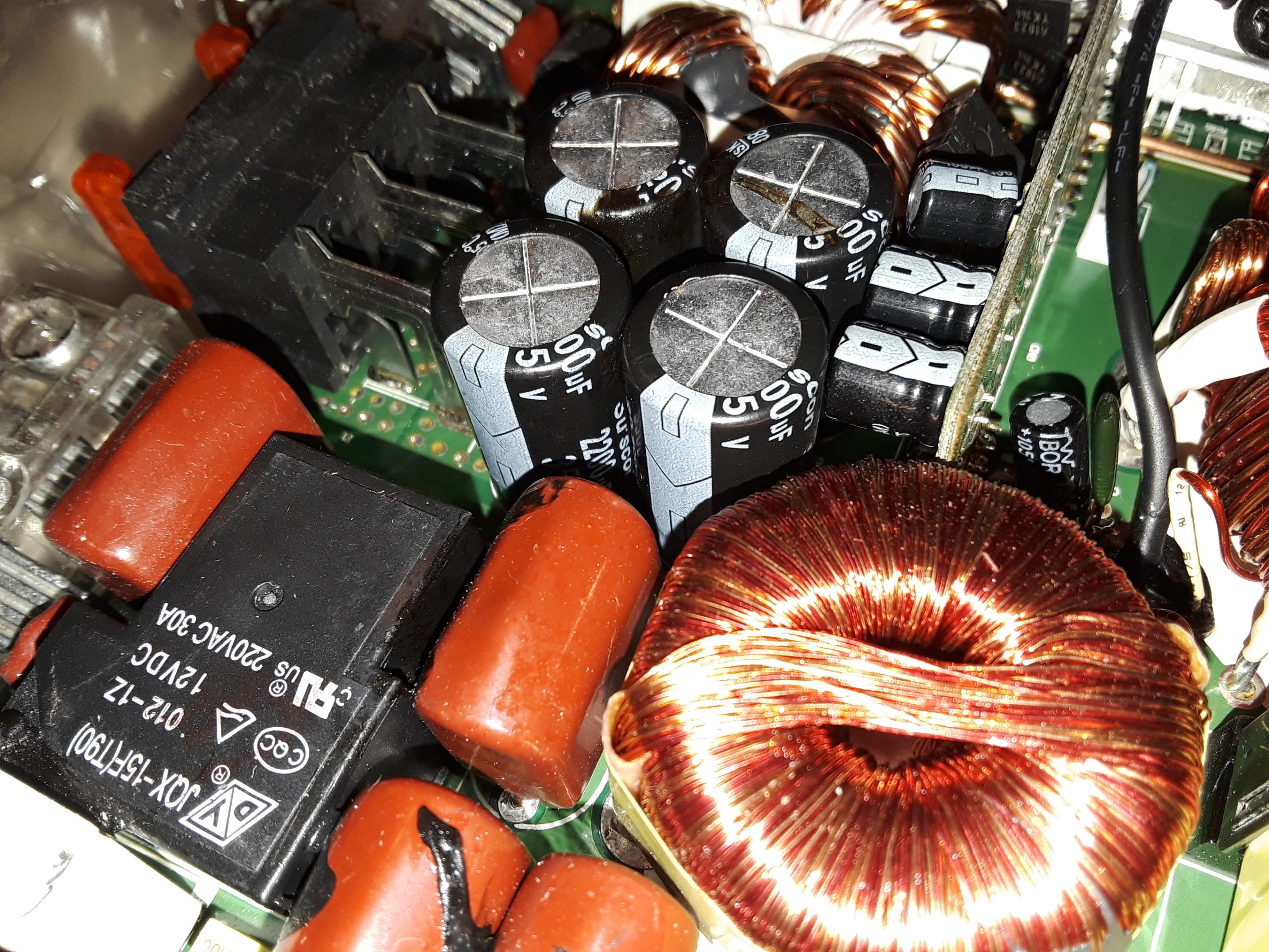

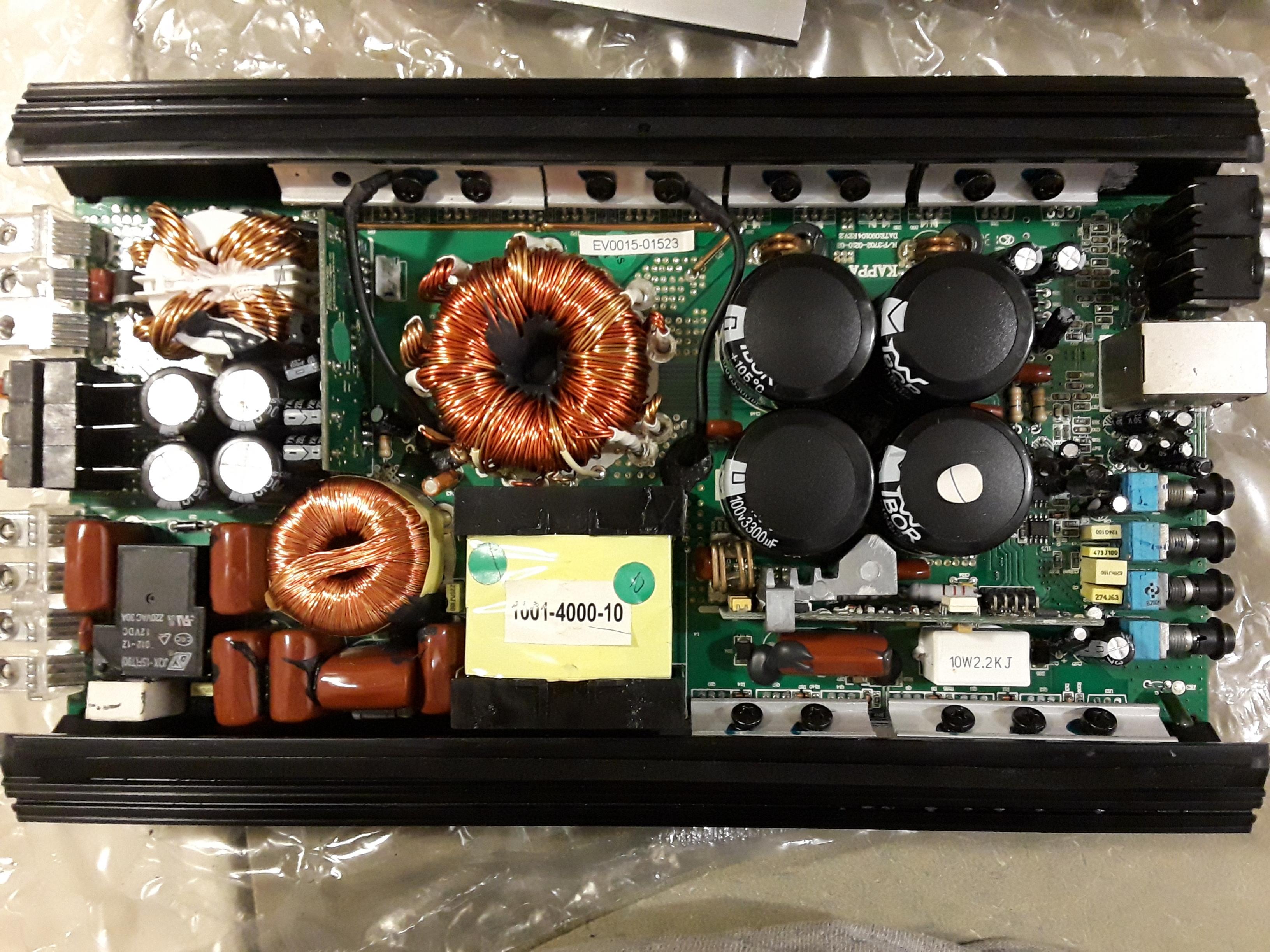

I dont know him but you can tell alot about a person by how they carry their selves and or express their selves. He didnt have to comment and help me from destroying and or wasting money. I actually did take his advice and adquired an non working amplifier. But im a bit dissapointed because its a mono amp and i dont use subs anymore( I am content with bass from my mids). First thing i noticed it was missing a fuse🙄 So am I an amp tech yet? Lol nop , but really I am dissapointed because I expected more from this amp. It is a Infinity kappa one. Harman kardon really messed that company up after bascom and arnie left(inventors of the infinty irs systems) after research all the caps are cheap chinese jun fu and bor hurngs. When I first picked the amp up my impression was wow its a really solid and heavy amp......
Heres a pic what do you guys think? Its a mono amp, what else can you tell me? No bulges on caps but some residue on 1 so probably burst
