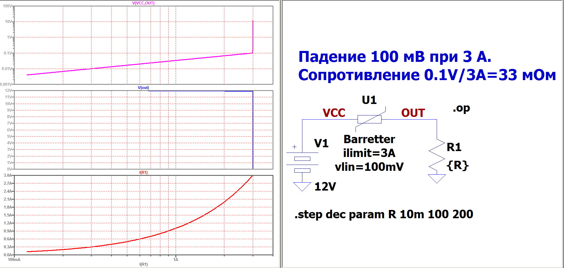

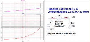

Hello. I want to simulate a guitar pickup, but i can get a way to limit the current.
I use this schematic.
I need to simulate the loading effect.
Thank you.
Thank you.
That plan is fine (when both pots are full-up). The 2.2H and 5.8k will cause sag when loaded. That's about all that happens inside a real guitar.
