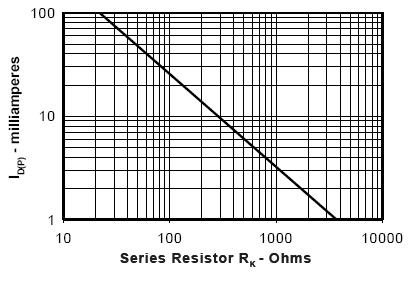

The data sheet only gives one spec related to this. It says for Rset=300 ohms, the current will be between 7 and 15 mA with a typical value of 10 mA. Obviously, this is a very wide tolerance.
I'm only used to this chart.
Where does it say it has a large tolerance?
