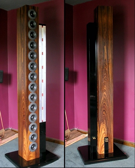

Those look like good magnets. Depending on the efficiency you want, I would think a single line of magnets on either side of the ribbon will give you a pretty good magnetic field in the gap. The 10mm width should be wide enough since ribbons move very little, probably a lot less than 1.5mm peak to peak, especially if you are only using it above 4k.
The 10mm thickness is also good and should give you something like .5 - .6 tesla across a 12.5 mm gap. You could probably get an extra 3db of output by doubling op on magnets to give you 20mm thickness but you shoul think about what mid/woof you will be using. It would be a shame to spend all the extra money for the extra magnets only to find you need to pad down your tweeter because it's too effeicient!
Best Regards,
Denis
My Ribbons Site
