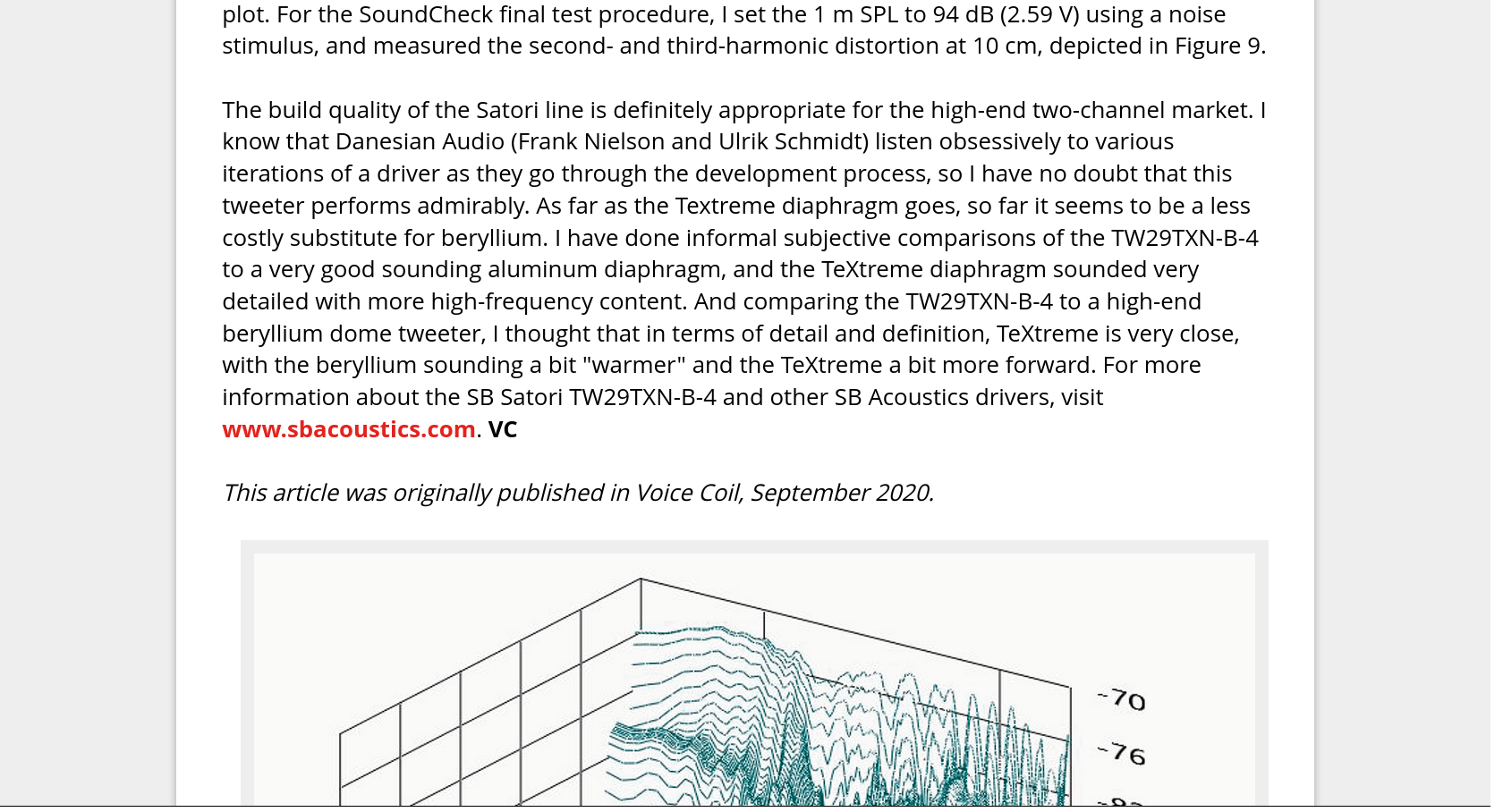

I am dispositionally incapable of Leaving Well Enough Alone. So, looking at the FR graph of the TeXtreme tweeter, there seems to be a "whiplash" dip and peak from 20kHz:
Now, the Beryll tweeter is not ruler-flat up there, but, it might be more benign:
So, my gut feeling, especially in view of all the praise the Satori Beryllium tweeter has had showered upon it, is that for a US price increment of say $300 on the pair of speakers, swapping out the TeXtreme tweeter and swapping in the Beryllium tweeter might make sense.

you will not be able to tell the difference between the tweeters based on their response at 20k or above, probably given your age above 12k and above. I'm skeptical you could tell the difference at all, I would keep the textreme tweeter. There is also a little bit of a sensitivity difference between them.

I never said I preferred the sound of the Satori Be to the TX. But I have heard lots of metal-dome tweeters I did not like. I am unpersuaded that a bump at 30kHz cannot be perceived via the initial transients.
I am not being paid to fine-tune the Sasandu kit, so I am not going to buy two tweeters. Most of my loudspeaker design work involves ribbons, from one specific manufacturer.
That's why I was seeking opinions from people who have heard both SBA Satori tweeters.
At the end of the day, it's the project of Chris at Solen, but if someone has some relevant information, I want to bring it to his attention.

Can't you buy the standard Sasandu TX and a extra pair of Be tweeters and swap? Like you say, for a few dollars more.
Those 3 lines above 20Khz won't tell you what the total dispersion will be like, nor how it interacts with your room, nor which you prefer (real or perceived)
Only you can suck it and see.
I guess if you do the comparison then test with either the utrasonic alarm or the phone ringing.this would give you the definitive answere i feel.
I feel the TX sounds smoother overall by comparison. What I see in the plots minus sensitivity level differences is still about a 5dB jump in about the same spot.
