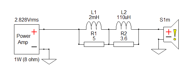

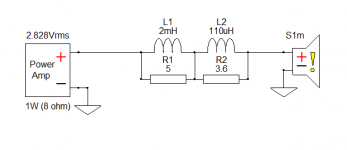

For a gentle down sloping response like the B&K house curve, you want a low pass filter with a resistor bypass. The low pass filter gives you the downward slope, the resistor bypass controls how much it drops. Usually you don't want to be anywhere near 6dB/octave like a 1st order low pass.
You will normally end up with an inductor in series with the speaker. That inductor will be bypassed by a resistor connected in parallel with the inductor. That's the simplest version, and the place to start.
The problem with just an inductor and a resistor is that you will be making a shelf filter. It will drop, then go flat. That might work on your tweeter, but maybe not so well for an overall filter.
To get closer to a curve like the B&K you'd need two sets of inductors/resistors. Here is an example that would be close to the B&K curve on a perfect speaker with perfectly flat response and a flat impedance. That speaker doesn't exist, but it makes the concept easy to understand.
In practical terms, you might want to apply the curve only to the tweeter, or maybe the mid and tweeter. And they will have complex responses and impedance. That's where using a crossover simulator and save a lot of time.
There are other ways to do this, some just by altering the crossover you already have. No doubt there will be other good ideas pop up in this thread. This is just a simple example to show that it can be done.

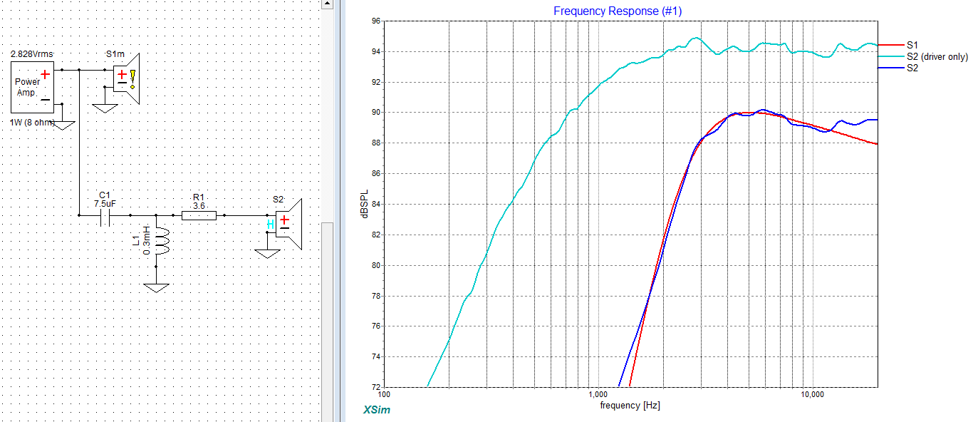

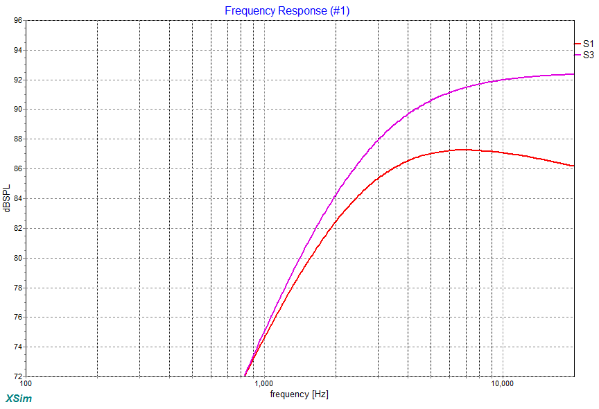

Here is an example of creating a standard tweeter target and adding a slope to it, just to show you where to go with this. There must be several ways you can achieve this.
Now as correct as Pano is, I've been able to cheat with a simulator here. I've used resonance to boost the lower passband.
Shown here are the tweeter before and after adding the crossover, which is aligned to the target.
