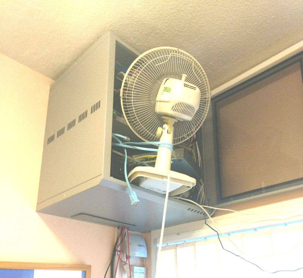

... fans and attached them....
Heatwave shmeatwave: Brit IT departments cool their racks – explicit pics • The Register
Yeah! That’s it!
