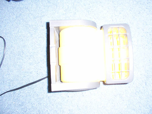

so many variables. i'm using a large fan and thus gonna try putting the ballast in the enclosure. (cause i'm worried about trying to ground it if i had it outside of the mdf enclosure)
this guy is about 9 inches long, at wallyworld, the lasko fan brands. squirrel cage design so i can use pvc that extends to the outside of enclosure, then blow cool air onto fresnels/lcds, then just put a small computer fan that sucks out the old air at top of enclosure.
(second picture is it after i took off the cover, and my light was too bright from camera. sorry)

more important then distance
If you are depending on distance alone to keep the lamp from overheating the ballast, then that distance should probably be at least a foot. But that is not necessary: You should have some sheet aluminum between your lamp and ballast, so light does not go directly to the ballast (or any other parts but the fresnel).
The aluminum will act as a IR radiation shield. You can paint it flat black on the lit side, to make it more efficient at transferring heat. Cooling air should move around the aluminum to keep its temperature down.
With a good shield and air flow design, the ballast could be just a couple of inches from the lamp.
