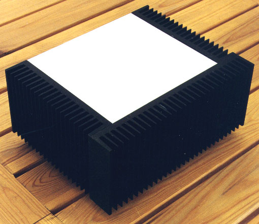

I´ve constructed the power follower (andrea ciufoly) with a bride of zen as a voltage amplifier; the sound is excellent, but it seems the heatsinking is a big problem; with 20% more heathsinking capability than the sugested, my amplifier is a little more than 25º C over ambient temp with only 1.3 A bias ( 10 W output)
¿does anybody have the same problem?
thanks in advance
some pics
the two box follower; one for the amp and other for the regulated psu
Hi, Freddie!
your comments are very welcome!
so the dissipation I have can be considered normal?
my room temp today is about 27º C and will reach 31ºC ( the summer in Spain)
so your amp will iddle at 61º C...
when mine is over 55º I´ve heard clics and other strange noises,
and I´ve shutted down...
may I ask you to send a picture of your amp?
what are you using as a driver stage?
many thanks in advance
Freddie said:
karellen,
I've also built a Power follower 99. Mine runs at 2amp, 100W dissipation per channel. I use heatsinks rated 0,34K/W. So heatsink temperature is around 34 degrees above ambient . (0,34*100W).
/Freddie
so the dissipation I have can be considered normal?my room temp today is about 27º C and will reach 31ºC ( the summer in Spain)
I don't have a picture of my amp (no digital camera). As driver stage I'm using a BoZ running at 100V. It really sounds strange that you heared clicks, and strange noises when the follower get hot. Mine is always really quite. I've been using this follower and BoZ for two years. But now I'm going to replace it..
