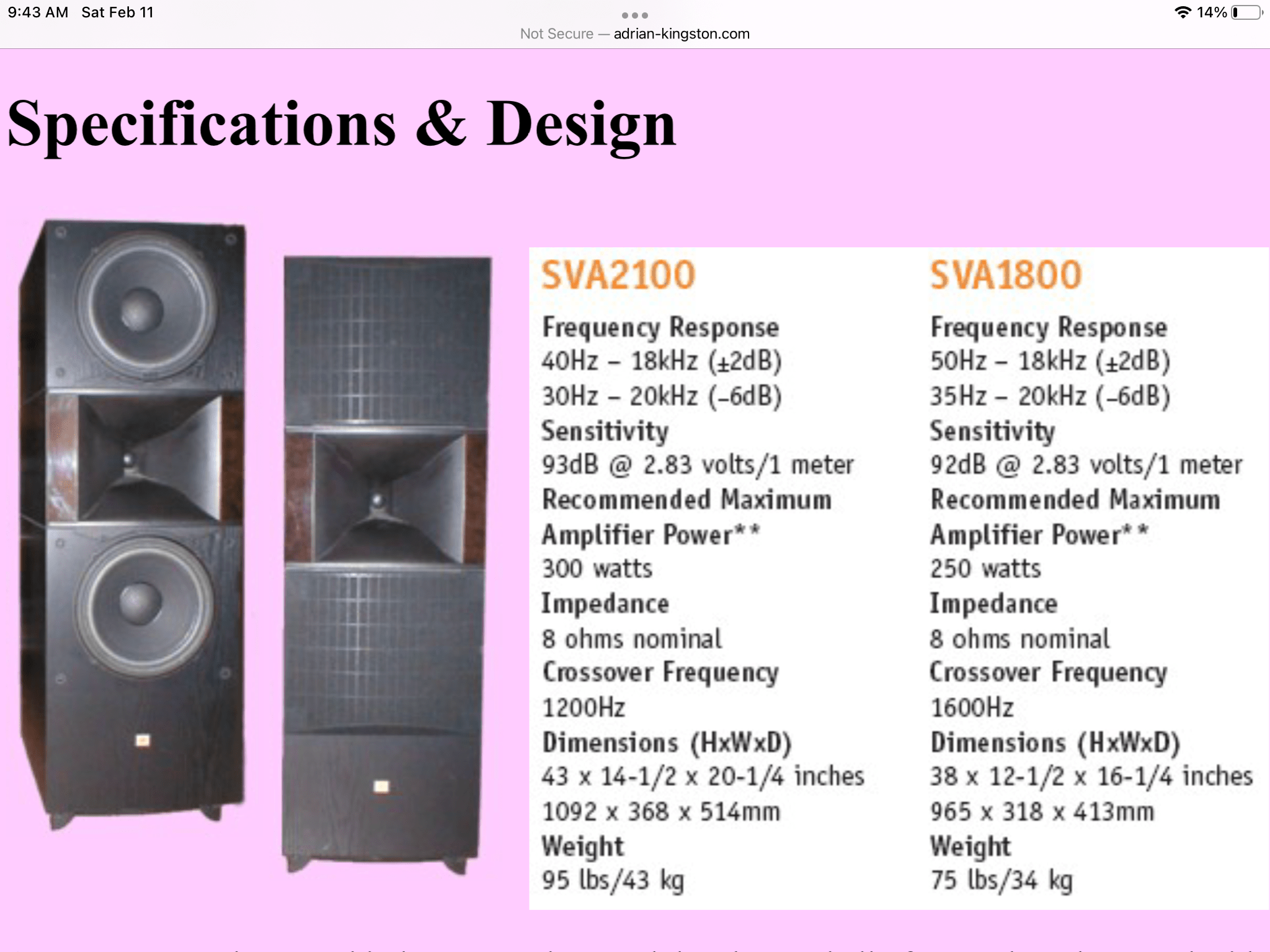

The highly regarded (by some anyhow) JBL SVA series used the audax 34mm dome in a horn with what must have been some sort of success?
I have a pair of TWO34XO and some SEOS-8 waveguides with intentions to mate them sooner or later…….problem is my stack of intentions is bigger than my stack of completions! 😎

Hi i know very well those speakers 5 years ago was about to buy them for a nice price
But I was abroad and scared at the idea of moving back home with too much luggage
I missed a pair of ProAc EBS for 800 euro The had a ATC mid between Scanspeak drivers
Crossover frequency: 1.2kHz from sva 2100 specs
Some PA 15" could reach than point i guess Just one would be enough
