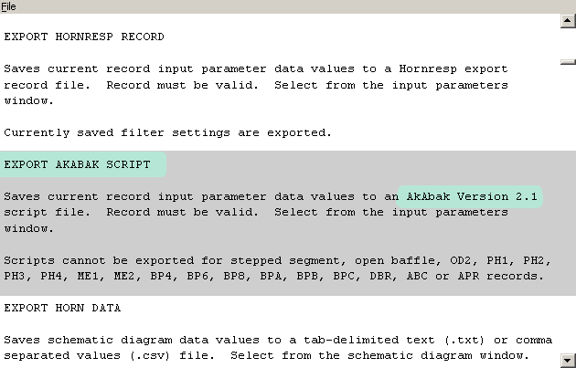

I modeled an offset horn in Hornresp and created below AKABAK script from it. Please help me figure how to import it into AKABAK 3.1.3.
Code:

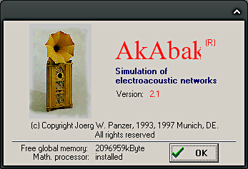

AKABAK 3.1 is a totally different software to the legacy AKABAK. (although made by the same people).
Thanks for clarifying that. I wrote to the software developer, requesting compatibility. Hopefully, it'll be implemented.
so to clarify - the export akabak script function in Hornresp generates a file that is useable by legacy Akabak.AKABAK 3.1 is a totally different software to the legacy AKABAK. (although made by the same people).
Akabak 3.0/3.1 cannot read this script.
If this is right I will dust off my old computer that can run the legacy version.
