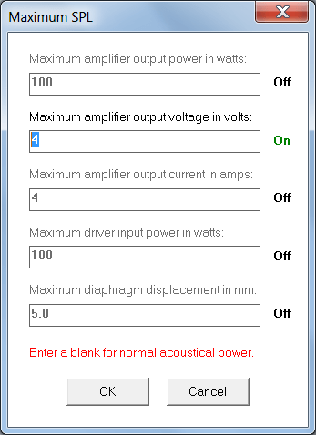

The standard power response chart is calculated assuming a constant input voltage Eg, not a constant power.
To make the power response and maximum SPL charts identical, set Eg = 4 volts (for example) on the main input parameters window, and use the input settings shown in the attachment for the maximum SPL chart.
If a constant voltage source amplifier is used to drive the loudspeaker (which is normally the case) then it would look like the first chart.

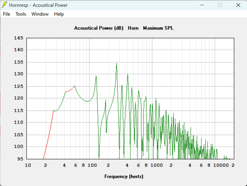

So now for my layman understanding I need to get a feel for how to interpret the max spl tool. I entered maximum amplifier power, driver xmax and as maximum driver input power I entered the driver RMS rating. Between 40 and 60 hz the driver exceeds xmax.
So in the range of 30 to 100 hz, what is the max SPL for this speaker. Is it 115 db,119db or 123db?

It is 125 dB. But that is a quantity of your decibels. What is the quality of these decibels is not shown here. 🙂 I mean, long before you reach these limits your ears will tell you that there is some problem coming. Distortion levels with increased power would be much more useful to show you limits of your speaker.
It would be good that you study distortion graphs at Hificompass site. He measures distortion on few voltage levels and is showing distortion trends with increased power. Interesting things are happening under 100 Hz, even for very big and expensive speaker units....
What kind of speaker you modelled here? If it is very small it will come to physical limits very quickly, even with low power levels....but it will not come close to 125 dB, that is reserved for very big constructions....

I do agree that one doesn't want to run speakers near their limit if fidelity is called for. But the graph is very useful in comparing different models and drivers. However I don't think my graph shows a max spl of 125. As I understand it now the graph shows the limit at each individual frequency and why it is limited. driver power handling, amplifier power or exceeding xmax.........basically "how loud does it get playing a frequency xxHz sinewave and what stops it from playing louder?"
I can't even remember what I exactly modelled......probably a 15" tapped horn. I am first trying to get some deeper understanding of Hornresp before I model the bass section of some rather ambitious omnidirectional speakers....trying to get the best compromise between bass extension, distortion, power handling and space. I am trying to get the best and loudest clean bass down to 27hz in max 300L of space with 2 opposing drivers to minimize resonances.

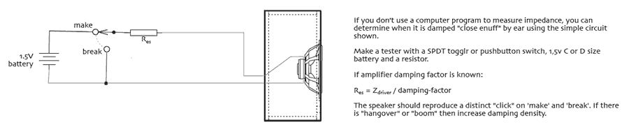

Partly; IME really need to know the history of sound reproduction to understand all the 'ifs and or buts' of speaker design, but pretty sure all 'your' bad sounding BRs would be at least pleasing 'enough' if critically damped.
