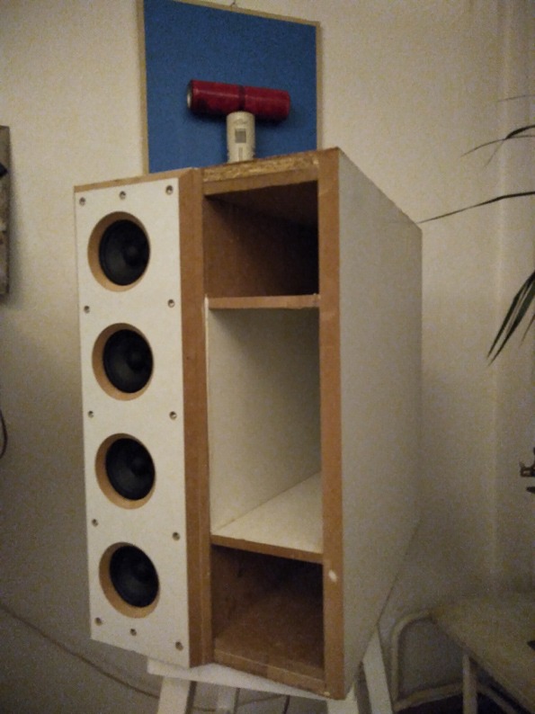

i did a tripel horn with 4x 3FE25, look http://www.hm-moreart.de/152.htm, 0,95 + 1,02 + 1,45 m
