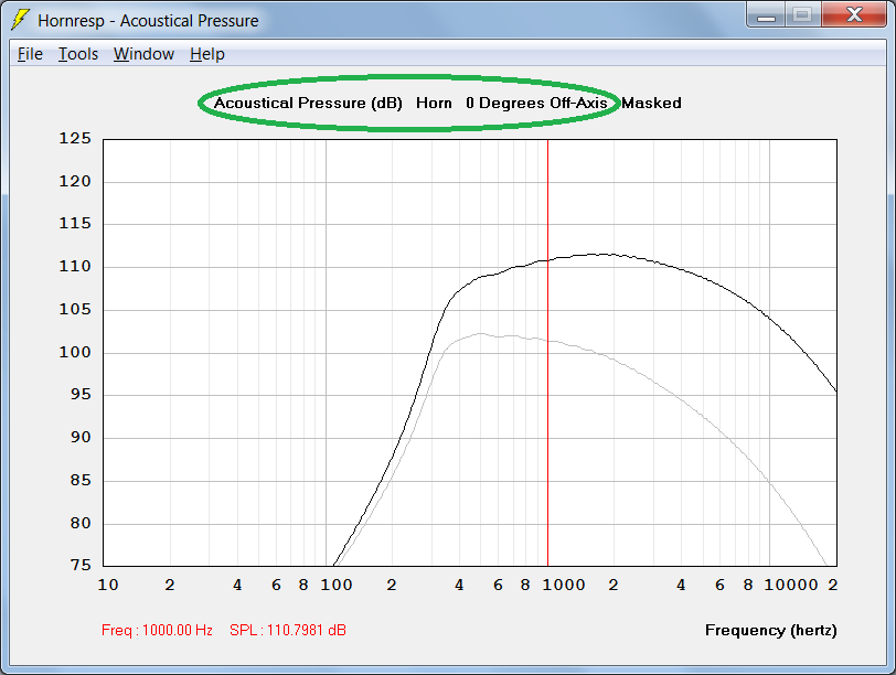

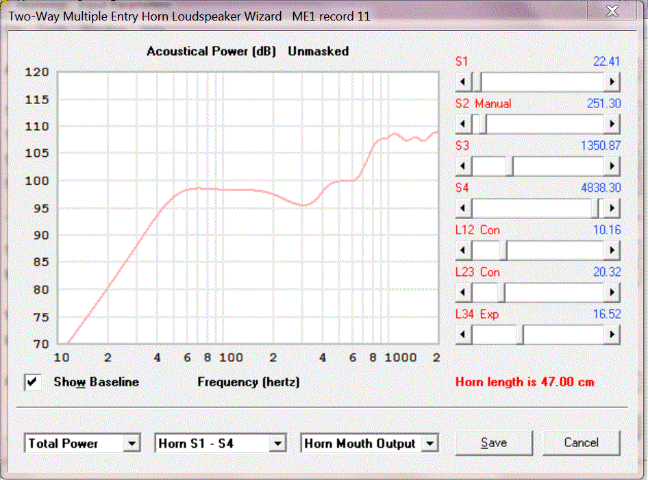

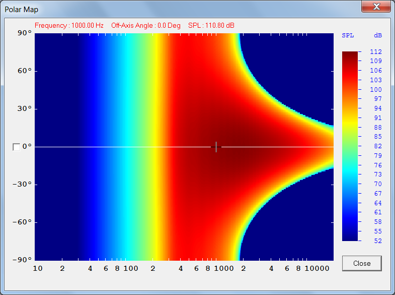

So I'm stuck at home with a cold and I've been wasting way too much time modeling speakers in HornResp today.
Here's some sims I did of the wavefronts of horns in HornResp.
First up is a plain ol' conical horn. Here are the specs:
1) The throat is 2" in diameter (6,750Hz)
2) The mouth is 15" in diameter (900Hz)
3) The coverage angle is 60 degrees
Second up is a conical horn, but with a flare at the mouth. This innovation was documented by Keele, and used by Danley in his Synergy Horns. Here are the specs:
3) The coverage angle is 60 degrees (Note that the coverage angle will expand a bit due to the expansion at the throat.)
In the sims, note that the polars are cleaner due to the gradual expansion at the throat. But also notice that the depth is quite a bit shallower also.
Subtle smoothing at the mouth of the horn from post #2 improves the polars, as illustrated above. Width of the horn is identical.

Patrick,
I can't really see where the subtle smoothing at the mouth is improving the polars (in that simulation, that is). The "lumps" within the horn are at slightly different places, but further out it appears they are visually equally smooth in coverage but the smoothed mouth loses directivity (starts to follow the angle of the widened mouth instead of the general walls) at the lowest modeled frequency, compared to the keele-type mouth. Via non-calibrated eyeball, anyway.

Patrick,
Nice catch Bill. That's what I get for playing with HornResp for seventeen hours straight lol.
Here's what happened:
In the last set of sims that I posted, there is a VERY subtle smoothing to the horn. If you compare the last, and the second to last, I smoothed out the spline a teensy bit.
The idea is to mimim what 18Sound and JBL do these days, where their waveguides have a VERY subtle curvature. They're largely conical, but the devil is in the details - smoothing out the transition from the throat to the body of the horn, and from the mouth to the body of the horn makes a measurable difference.
But here's the problem:
In my last post, at 2:30am, only HALF of the pics have that subtle adjustment. The sims at 1000Hz and 2000Hz have that subtle adjustment.
You can see the difference if you compare the 2000Hz simulation from Post #2 to the 2000Hz simulation from post #3. The difference is that the wavefronts in the latter are smoother. They also to be "brighter" which would indicate the waveguide will be louder.
In the real world, what I've noticed with waveguides that follow this criteria, as detailed in the "great waveguide" thread, is that those waveguides are measurably smoother. The QSC 60x90 waveguide in particular:
Having said all that, note that the biggest 'bang for the buck' appears to be simply increasing the expansion rate for the last third, like Keele recommends and Danley does. But if you want to get that last 5% out of the horn, it's worthwhile to get a big file out, and grind down the transition from the two angles, so it's perfectly smooth, particularly at the throat and the mouth.
Another interesting thing you'll notice from the Hornresp sims is that the wavefronts will 'detach' from the walls in a conical horn once the angle gets wide enough.
Last year I ran some sims using the 3D software from the Akabak folks, and that seemed to confirm that. (Not recommended! Took me all day to get one sim to work.)
