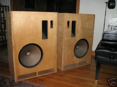

A standard prosound box will mount a standard black horn externally onto a black baffle. Simple.

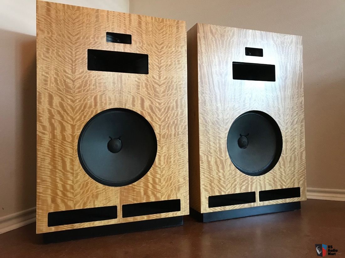

The examples pictured mount a standard black horn on the back of a nice timber baffle.
I think this is good, aesthetically, but these examples have a big sharp lip at the horn mouth, which seems like poor design acoustically.
Are there any similar builds - that mount the horn to the back of a nice baffle - but which have the baffle cutout angled to match the horn mouth angle?
I'm curious how this would look, and (if someone has done it) how they machined the cutout to get it to match up perfectly with the horn.

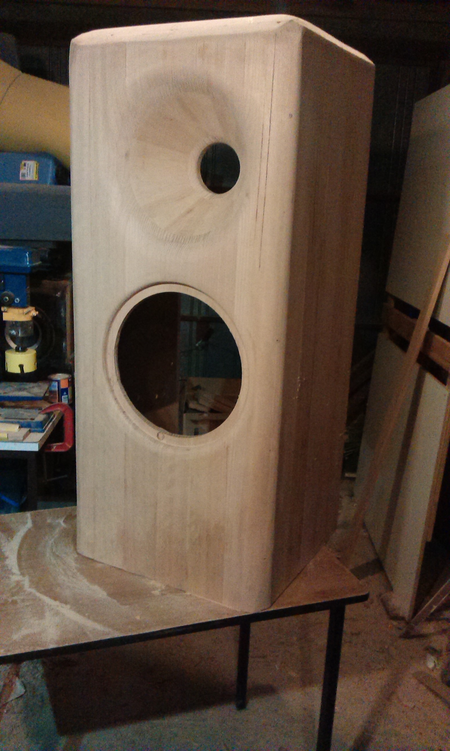

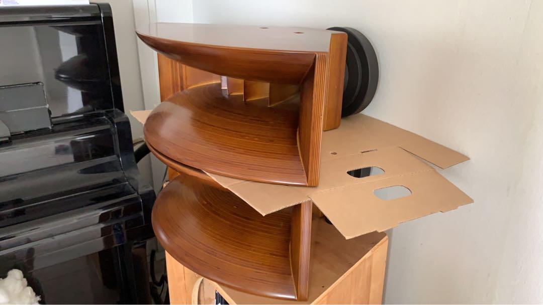

e.g. I like the look of this previous build (pictured), and of laminated ply horns, such as the Yuichi style horns (pictured).
...but I'm not very good / patient / well equipped for making something like the latter; I tend to build things 95% correct, then use a lot of time + sandpaper to get the last 5% right.
For a conventional horn, this gets very fiddly and awkward towards the throat. Hence it would be easier to:
- stick a wood baffle in front of a premade horn
Or
- make the mouth part of the horn from wood, and use a some hacked or found or cast object as the throat section.
That previous build used a found object: a hacked Ikea bowl. Something like that, but to a much smaller throat, would be ideal.
The only existing example I know of that does this is the (crazy expensive) AH! / Cogent horn.
