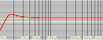

I don't know if that was typo or not, but an enclosure of 8 cubic meters is about 280 cubic feet. With something that size, I would suggest forgetting about transmission lines and go for a set of super-efficient PA speakers.
Something to fit the bill would be a set of four Fane Colossus 24 inchers in 2 X 2 arrangement, tuned to 16 Hz. The four together raise the sensitivity to 107 dB @ 1M/1W, and if you pump 1,000 Watts through the whole system, you arrive at 140+ dB at 16 Hz. Surely, those figures constitute horn-like output and sensitivity. That is not even counting room gain, assuming there is a room still standing at the completion of the test.
Just set 'em up in your 8 cubic meter enclosure, and get ready to blast the bejeezus out of your neighbors. Which is only fair, since they are certain to want to come over and blast the bejeezus out of you.
The following is the response for 4 Fane Collosii in an 8 cubic meter enclosure:
