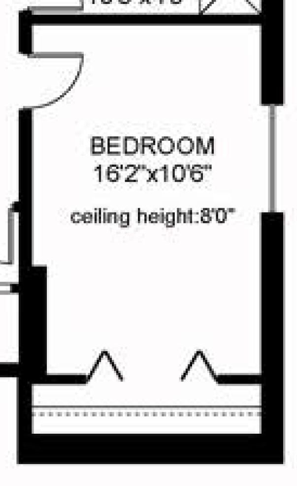

This is a project I've wanting to tackle for some time. I now have a pretty decent room to set up a nice little theatre that would require a riser for the rear seating. So why not a pair of subs in the riser?!
The gear and projector will be at the closet end and the 2 mirrored 58"X60" horns will be in front of the gear. This end of the room is earth/rock filled, this is why the walls are thicker. The sub's internal baffles will 11" high giving me an overall riser height of about 12.5". I want to make it in two sections for portability, I expect to move in a few years.
Why not 60"X60" boxes? the room is about 2.5 inches shy of 10 feet wide and besides, I've learned not to trust the squareness and flatness of typical construction! A bit of trim will fix the gaps.

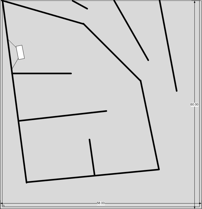

I have a preliminary sketch attached, also specs for the drivers I would like to use. I have a HSU sub plate amp and I expect to run the 8 ohm drivers in parallel.
The cone area would seem to dictate a throat size of 5"X11" .
From here my plans get more sketchy, I'm thinking these drivers would work fine in the approximate 9 cubic foot volume sketched. The horn length is about 12 feet (very approximate) a length, I recall reading somewhere, that would allow bass to extend to around 25 hz.
Well that's my crazy loosey goosey plans so far. 🙂hypno2:^
Clearly I need help and would welcome input and ideas from you Horn Experts!
Thanks!!!

I have to make a riser anyway and thought I may as well try a project that's interested me for a while. There is a volume of almost 600 cubic litres available per sub, which I think should provide some creative options. I'm totally open to thoughts on my scheme and alternate ideas. I don't need this sub's range to reach higher than 70 hz either.

After a lot of wading through the threads the "Kraken" design does seem to hold some promise.
I would really like to utilise as much of the of the cubic footage as I can, I believe it holds some serious potential for a sub.
