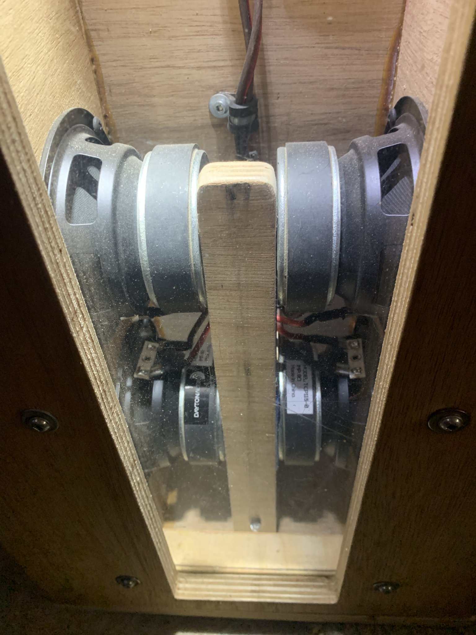

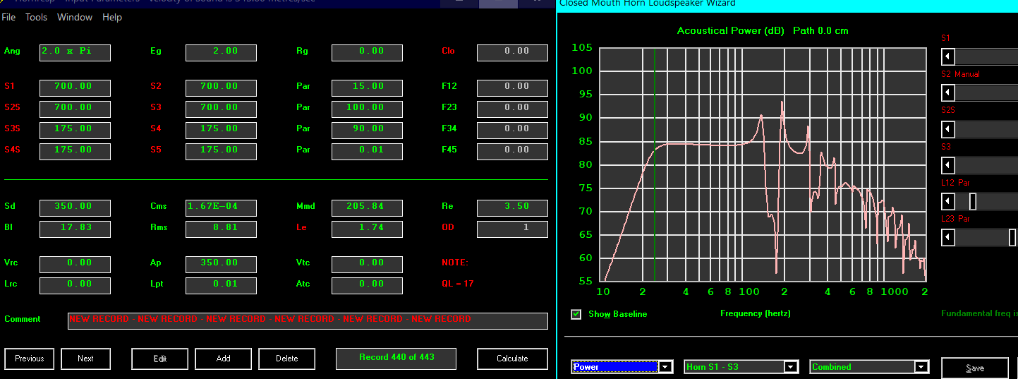

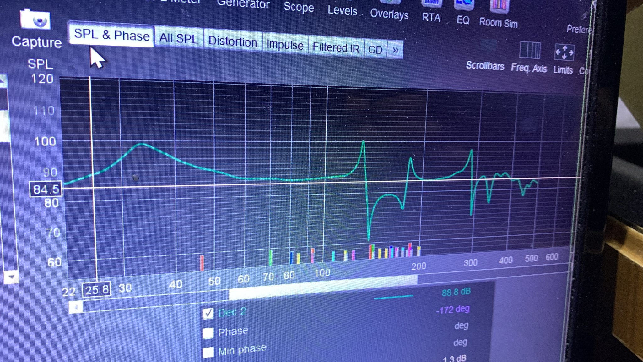

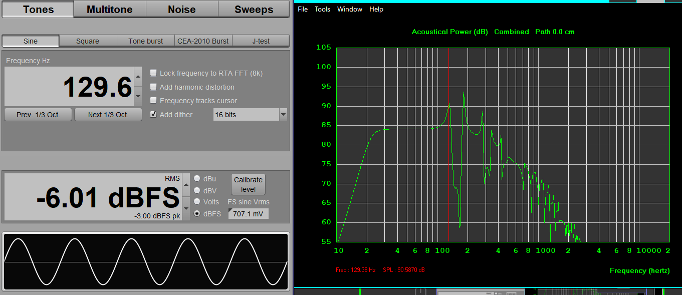

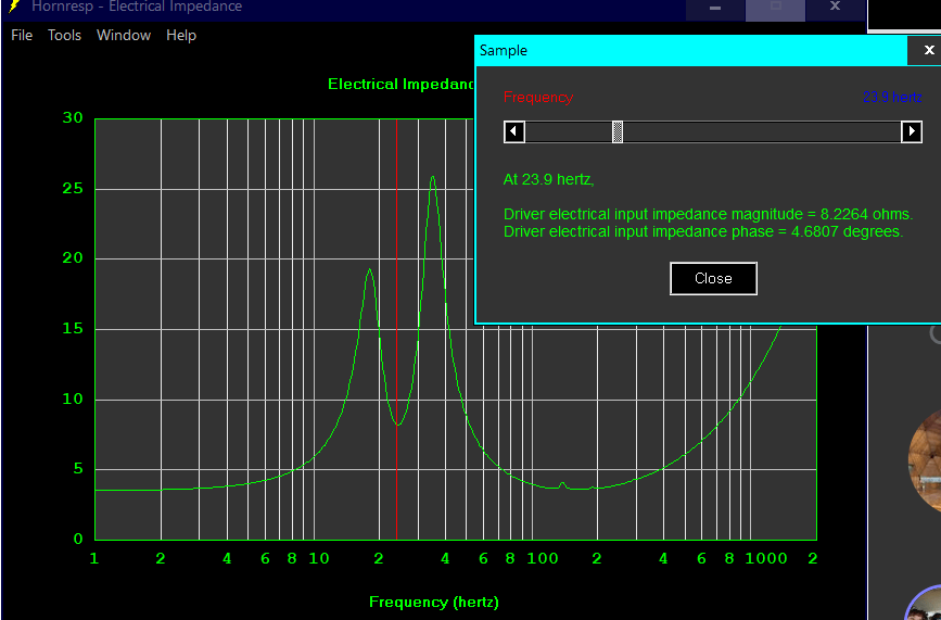

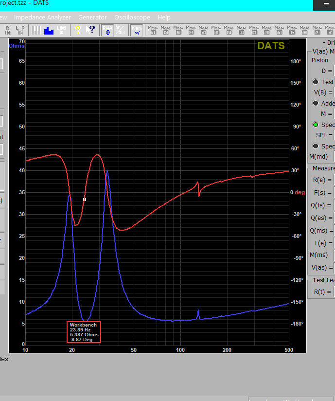

Horn response is ridiculous
Ridiculously Spot on!

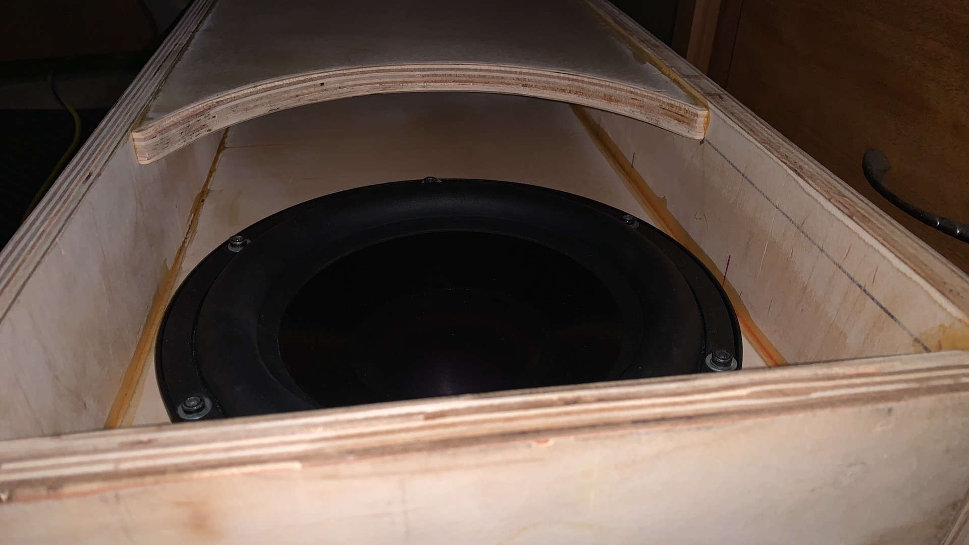

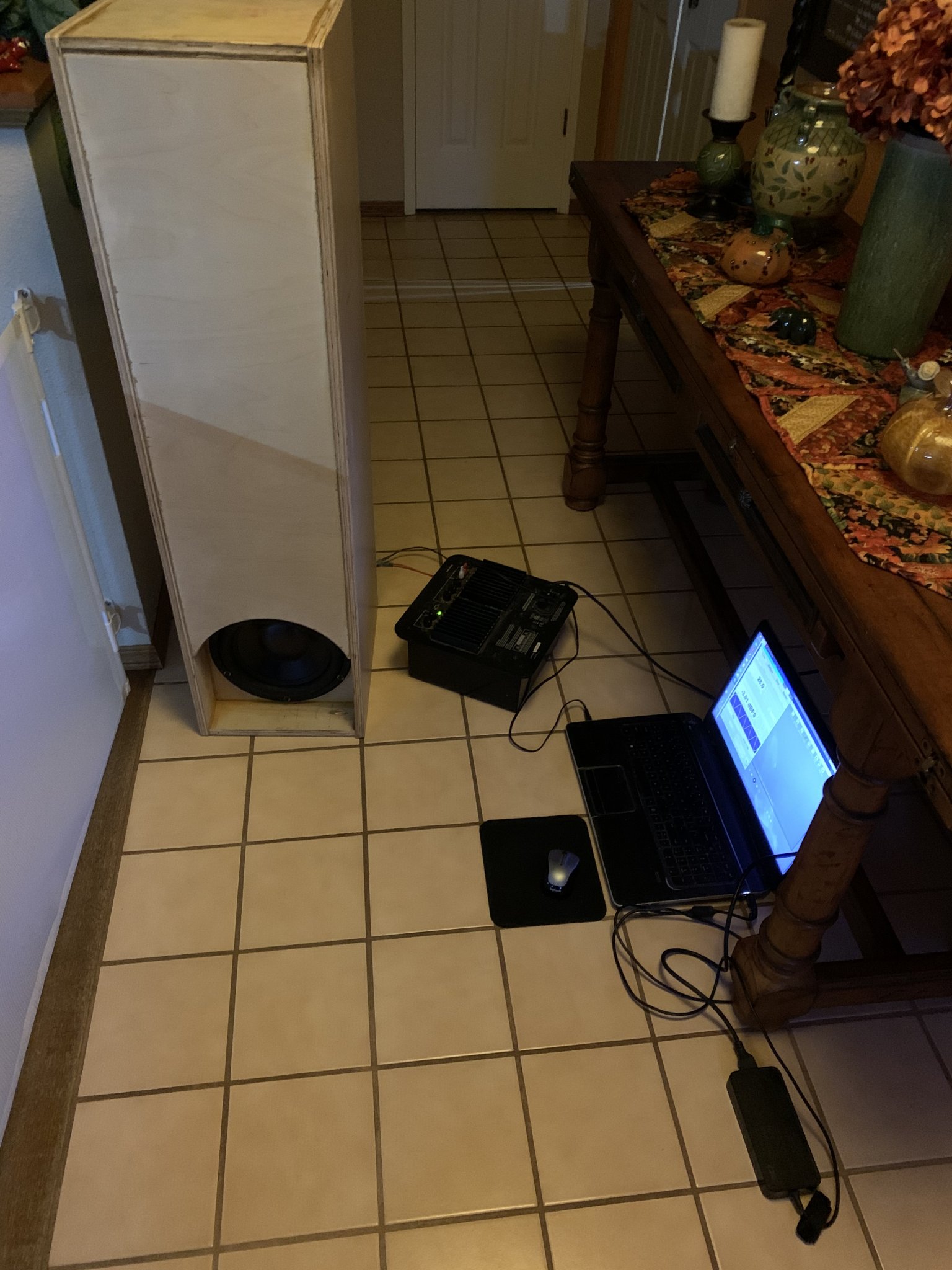

Dayton Audio Rss265ho4 in a big bass reflex

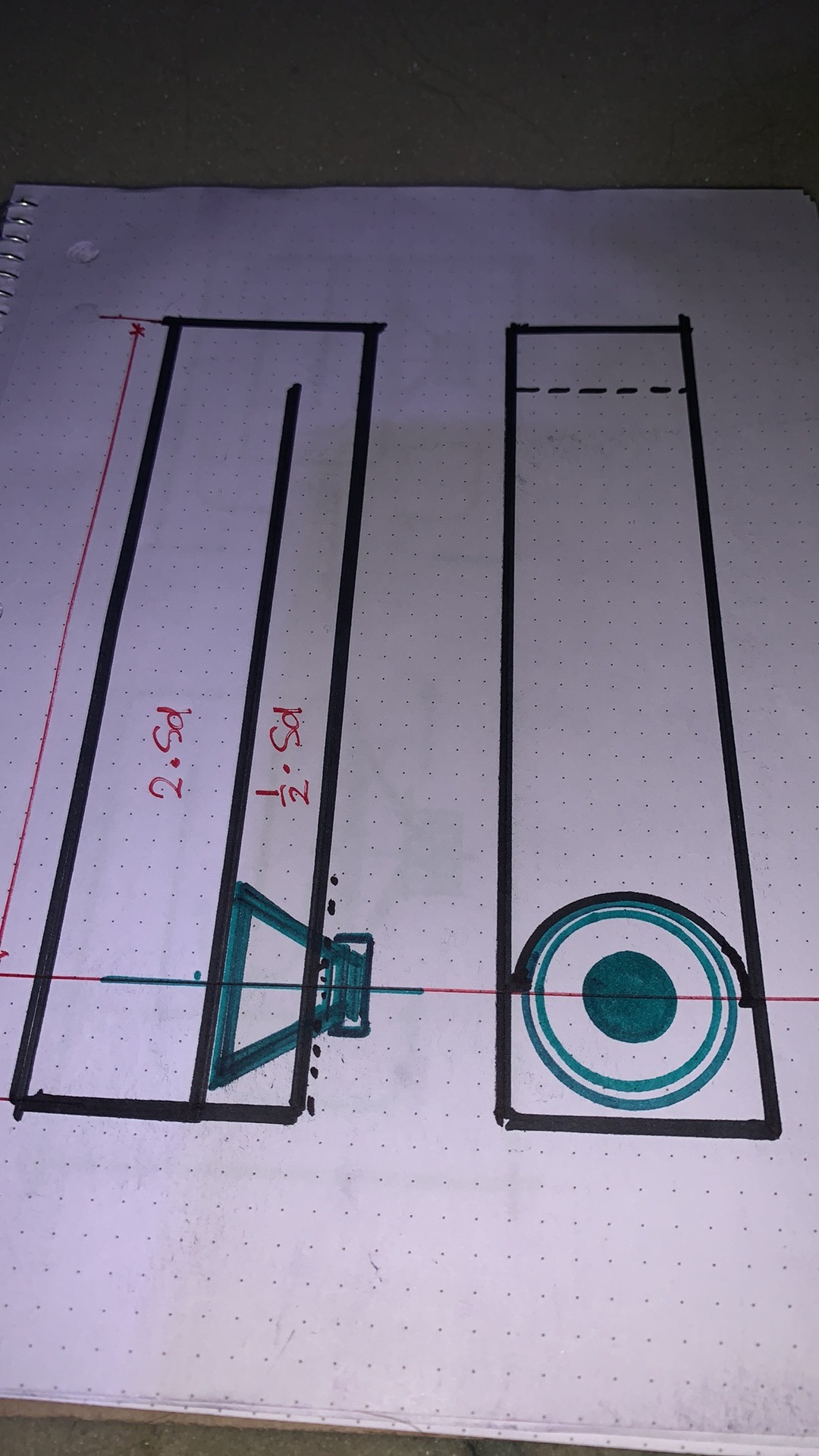

I wonder how much different/better/worse this design would sound instead of a single driver in a much bigger/Lower tuned TQWT.
i ‘assume’ I like the long skinny boxes more because the fundametal doesn’t generally present a peak /underdamped shape and overwhelming (especially with room/cabin gain) sound that stands out in certain music?
