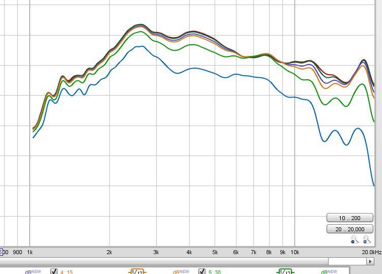

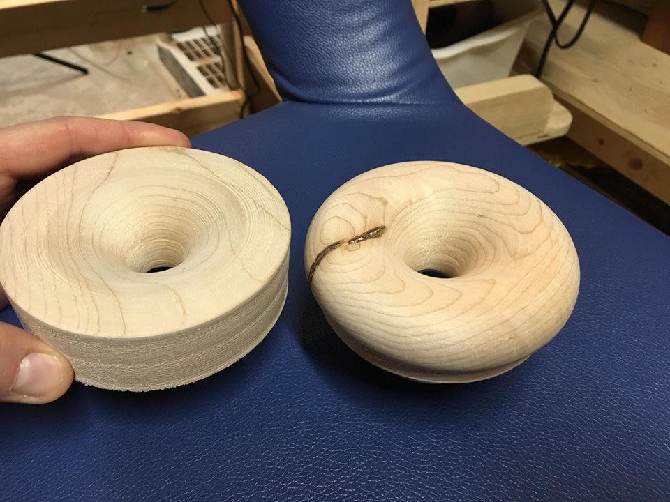

In my testing there is a definite measurable benefit to rolling the lip all the way around 180 degrees.
I measured the raw response of two different horns on the same driver. The one horn is the JMLC horn which features the rolled lip on the horn exit. The other horn is identical except the it does not have the rolled lip. See how superior the off-axis response is of the JMLC horn. Off-axis angles are 0,5,10,15,30,46. There is a noticeable difference in sound quality between the two as well. The compression driver is the BMS 4256-08 ring radiator, 5/8” throat, neo magnet.
Joseph Crowe, which is which?
The one on the left looks better to me, the other has an off-axis peak at 8kHz out to 30 degrees, even thought it appear so have better directivity to lower frequencies.
The plot where all the lines look similar is the JMLC horn. If there’s any deviation in relation to the other lines it would be due to edge diffraction off the horn mouth. Edge diffraction is stored energy that shows up in the time domain...namely impulse response, and waterfall plots. This would have direct negative impact on the sound quality...namely dynamic range.
The plot where all the lines look similar is the JMLC horn...
I am surprised at how similar they both are, in different ways, can you be specific - L or R ?
Best wishes
David
It actually looks like the compression driver wasn't centered in the horn's throat as well in the right-hand plots as it is in the left hand plots (or the throat diameter of the horn isn't quite as symmetric). The concentricity requirement of the throat is usually in the 1/10th wavelength regime from experience (about 60-70 thousandths of an inch at 20 kHz, or ~1.7 mm). I've seen that effect before above 9 kHz with 2" compression drivers.
Beyond that, the polar plots down lower in frequency--where the effects of the mouth roll-out will be most prominent--are telling me that continuing the mouth roll-out beyond 90 degrees has no visible effect on the polar traces. Is that what you are referring to?
Chris
Driver alignment is within .010” . Also the transition from driver to horn is precisely matched both in exit angle and diameter. This is often overlooked. The horn is designed to match exactly to the BMS driver specifically.

That holds true if the horn mouth termination does not eliminate edge diffraction entirely. As a secondary means of dealing with edge diffraction you could go with oval or rectangular which will spread the diffraction around. My kids spread their food around their plate to make it look like they ate more than they did. Pretty clever.
