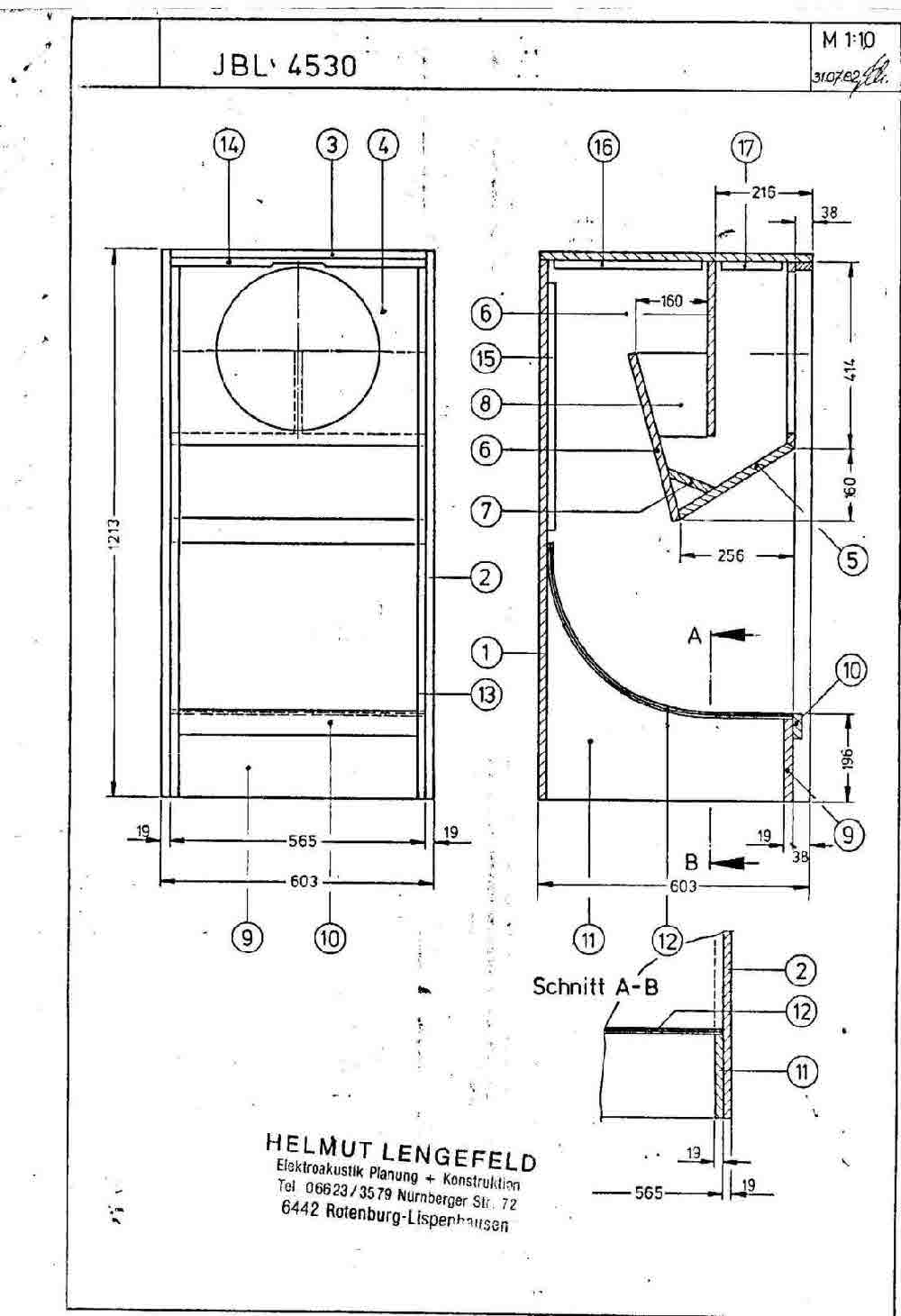

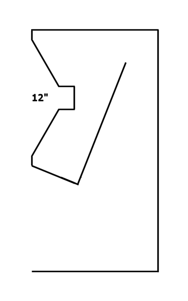

Is anyone on here familiar with the design of guitar speaker whose cross-section is shown here?
I built one of these a long time ago, following a design in "Sounds" weekly music paper, published in the UK, sometime roughly around 1977 to 1979.
As the diagram shows, the front of the speaker is open, and the rear works into a compression chamber that vents into a constant width, increasing height horn.
I don't have the speaker or the original article now, but it worked very well indeed, great tone and very efficient. Any information gratefully received!
Rear loaded folded horn is another name that these things seem to go by.

Nope, haven't seen one of those, but it looks plausible. Don't try to make it any smaller though, from my work with transmission lines, I think the horn length needs to be about 3 feet, minimum, for a guitar.

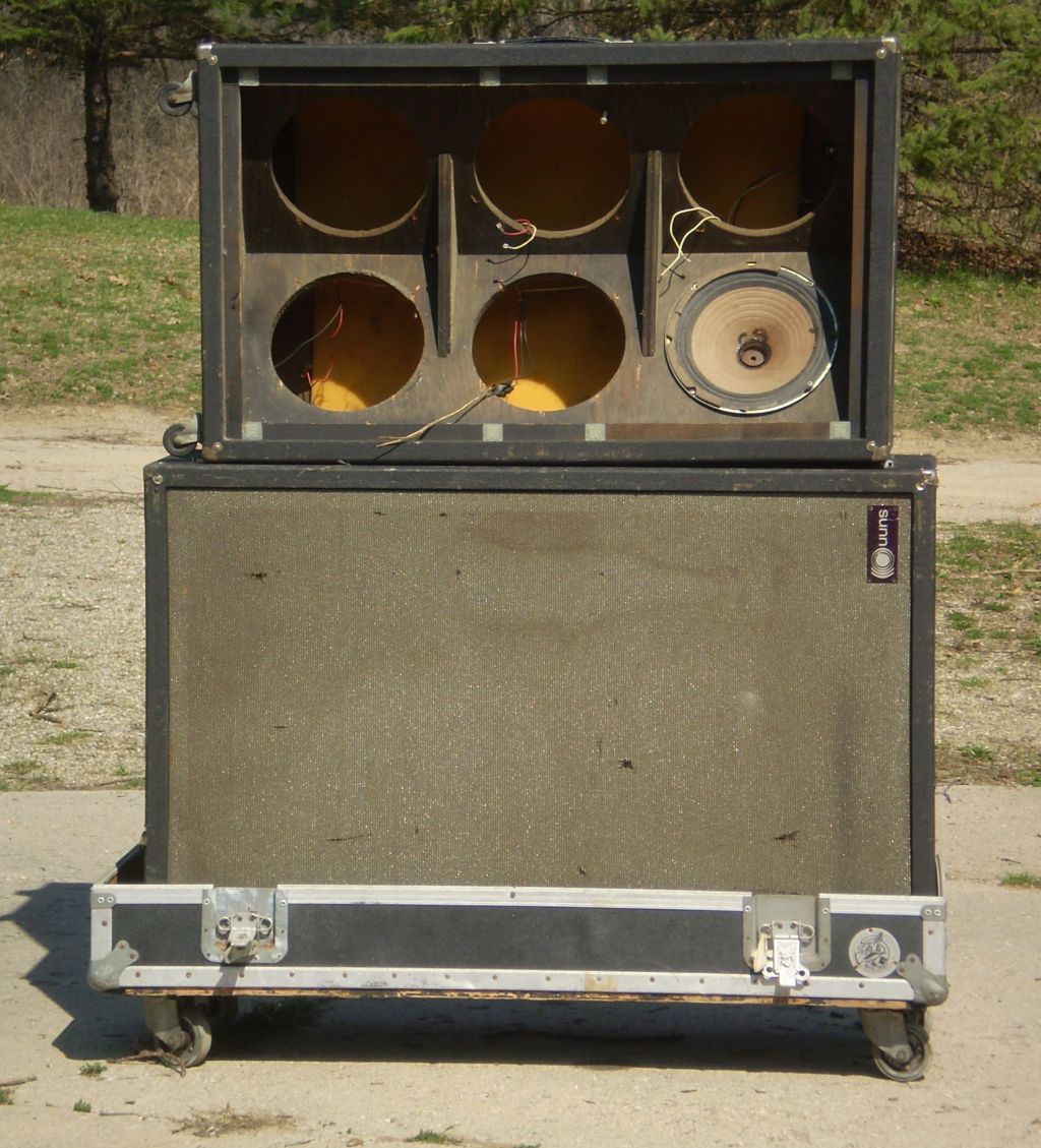

Music Man made 1x15, 2x12 and 1x18 cabinets like that in the late 70's. JBL also made a large "Scoop" cabinet with 2x15. There is usually a null somewhere in the upper bass region where direct radiation is canceled by port radiation.
Sunn also made cabinet of such of a design.
The Sunn 215.
I was just digging out My old guitar rig and I am starting to get it back together with some new drivers.
Right now I have some old Altec Lansing's in the 215 and I used to have some 400/800 watt MCM Select's in it.
I have a set of some Pyle PPA10's that I will be installing in the 610.

That's gotta be a pre mid-69 2000S cab on the bottom. A little different from what the OP posted because the port doesn't flare at the face. Sunn gave up on that design around 72 and made cabs with the flare like the OPs diagram. The 6x10 is probably mid 70's vintage.

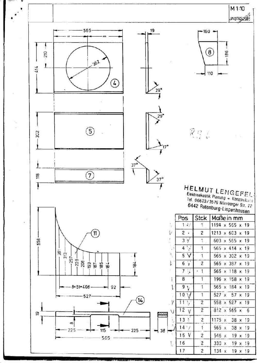

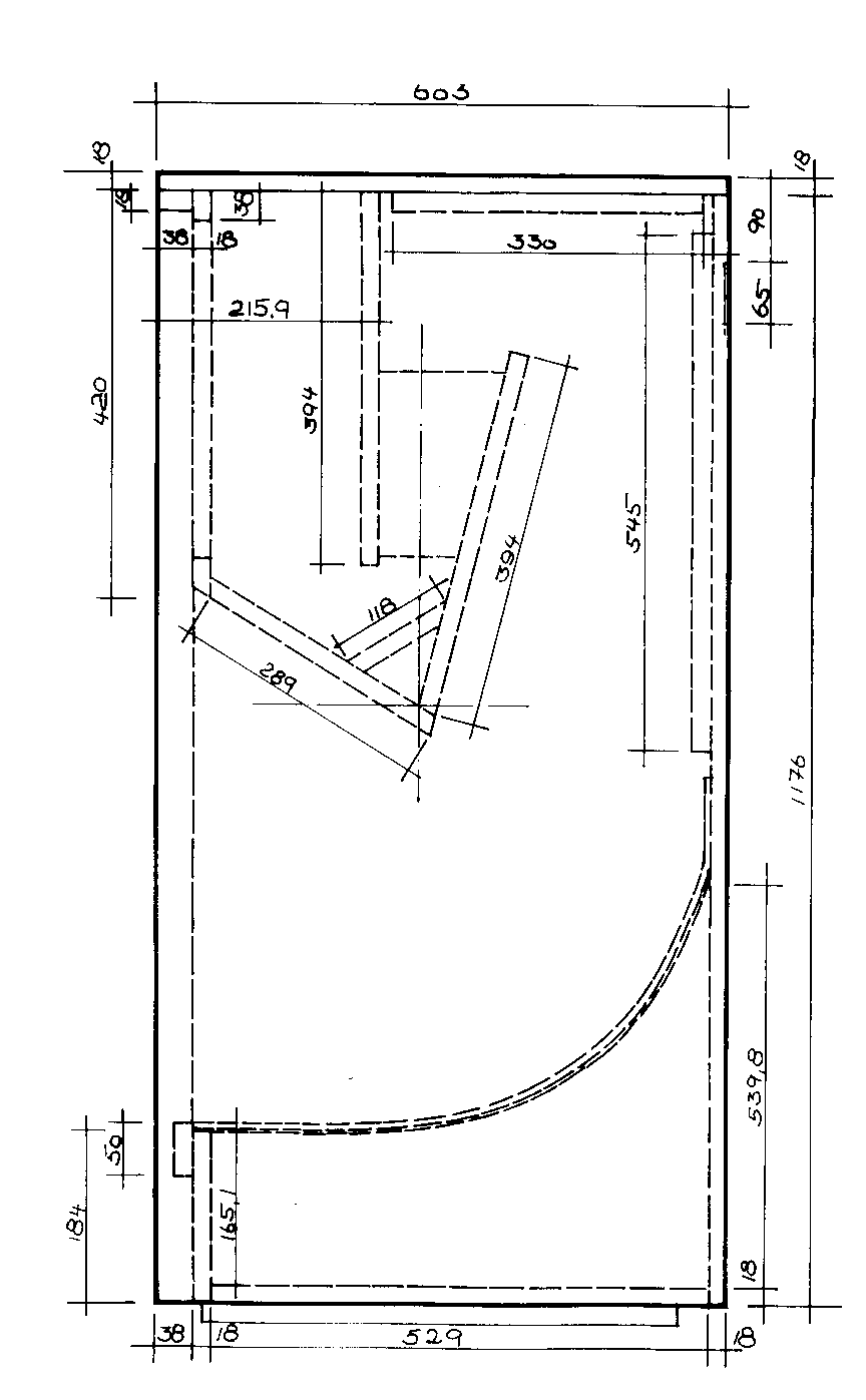

Thanks for those JBL diagrams Roflynn. They show a more sophisticated design than the one I built, which would fit with their intended use, ie essentially hifi, as opposed to electric guitar.
That said, the JBLs are beautiful things, and I can see how they were quite probably the starting point for the design of the one I built. Really nice to see those pictures.
For anyone interested in the JBL 4530s, the jbl site still has some info up at https://www.jblpro.com/pub/obsolete/Low_Frequency_Enclosures2.pdf
