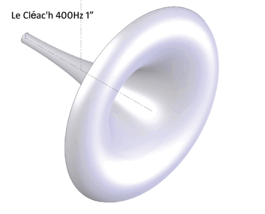

Do anyone have experience with horn loading dome midranges? In this case Dayton RS52AN in a Le Cleach horn pictured below.

The pictured horn is a 1" throat, so with a 3" dome it will be much shorter, still skeptical though since after shortening it there is no way back...

Sorry I didn't look at your first picture , which is too narrow in the throat ,and too long , for a dome .

horn loading that would not be very smart.
waveguide loading it would be a good idea.

Why that?
A dome loudspeaker will perform better with some acoustical loading.
A good horn will provide a better loading than a waveguide to a dome loudspeaker.
One of the classical example is The Dynaudio D-54 mounted on a tractrix horn.
"The Dynaudio D-54 in a Edgarhorn is reputed by the "Sound Practices" group to be the finest midrange in the world."

For me it (may) matters also if the dome midrange is flush mounted or not. So that 1-2 mm baffle non alignment counts. For that particular shape of the dome ,the reflections of the first part of the throat like in Defos post #1 would cut more that 50% of energy radiated , producing only a narrow beam , which often is opposite to the wide dispersion we're seeking.

i agree *some* acoustical loading ( waveguide ) will do a dome good.
but if you're going to *horn* load something - why not use a driver *designed* for horn use - namely a compression driver ?
now i am not saying that it *can't* work. it is *possible* that some dome in some horn may work well but the approach itself seems misguided.

The objective is dispersion controll and high sensitivity for good dynamics with no harshness. Dome midranges is also 4 times less expensive then Radian 2" compression drivers, which would be my choice because of mylar suspension and aluminium diaphragm (better then titanium at least...).
The pictured horn in first post will be 22 cm long after cut and as you see it has a large roundover.
