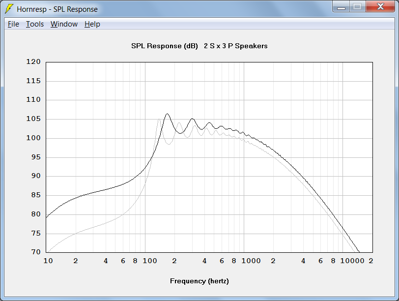

So... Theoretically, one would be able to group 6 horns with an L12 of 100 and S2 of 385 and get nearly the same effective mouth area and response as the longer, larger horn?
What got me thinking about all this was looking at Olson's paper that had response charts for different lengths of horns with the same flare cutoff and throat size and the responses were relatively similar, not taking into account the major impedance fluctuations presumably caused by small mouth sizes.
Thanks again David.
Thanks again David.
Hi dustman96,
I'm not sure that your observation above is strictly correct, but it seems you may get reasonably close - the black trace in the attached chart shows the Hornresp predicted power response for six 100 cm horns connected in a 2S x 3P array radiating into 2Pi space. The gray trace shows the response for a single 150 cm horn radiating into 2Pi space.

Hey David,
Thanks for running that through Hornresp and sharing. Pretty interesting. I wonder if the slightly smaller mouth area of the 6 horns as opposed to the long one makes the difference. I bet in the real world the coupling wouldn't be perfect so response might suffer slightly. I don't want to ask too much of you but if you have the time would you mind throwing just a single foreshortened 100cm horn onto that graph as well?

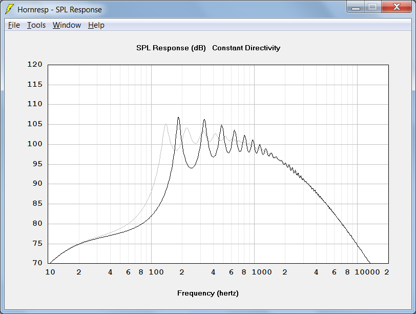

Hi Dusty,
For you, just this once only 🙂. My very strong preference is for people to spend a little time learning how to use Hornresp so that they can try these things for themselves - it is by far the best way to learn, and to understand what is going on.
That said - the black trace in the attached chart shows the Hornresp predicted power response for a single 100 cm horn radiating into 2Pi space. The gray trace shows the response for a single 150 cm horn, also radiating into 2Pi space. As expected, the response of the 100 cm horn is more "peaky" than that of the 150 cm horn because of the smaller mouth size and the resultant poorer mouth acoustical loading. Even though both horns have the same flare rate, and hence the same theoretical cutoff frequency, the longer horn has slightly better low-frequency extension for the reasons outlined in my earlier post to Art (weltersys).

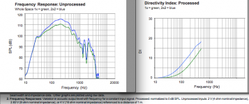

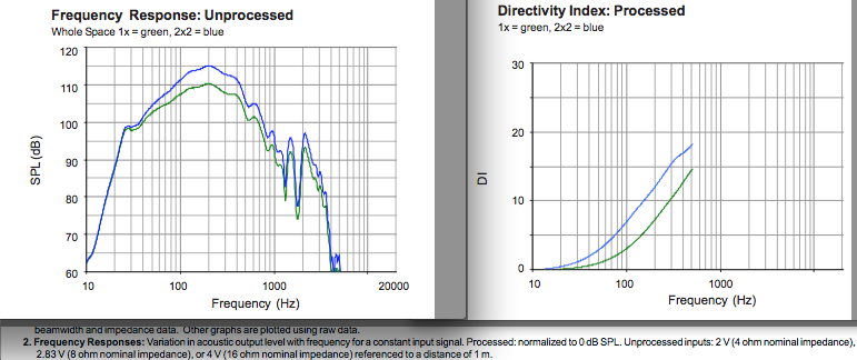

I don't think bass horns couple below 200hz.
take a eaw kf940.
http://www.eaw.com/products/KF940.html
http://www.eaw.com/info/EAW/Loudspeaker_Product_Info/Current_Loudspeakers/KF940/KF940 SPECS_revA.pdf
dual 12" bent bass horn.
13' long path, maybe 3-4ft2 of mouth.
This is their graph on their pdf sheet, not a simulation.
Notice how 4 boxes couple well at 200hz but not at all down around 30hz.
but you can boost the low end.
And 8 drivers (4 boxes) will handle 10db of boost better than 2 drivers.

Rest assured, bass horns do indeed couple below 200 Hz.
Also, 10 dB of boost is exactly the same with 2 drivers or 8, multiple voice coils just make a bigger fire😉.
The increase in upper level of the EAW KF940 "unprocessed" chart is due to the increased upper directivity focusing more output level in front of the multiple cabinet array when compared to a single, while the mostly omnidirectional low bass has very little DI increase, and therefore relatively less gain in multiples.
The response of the low bass looks like it has hardly increased (about 1 dB at 30 Hz compared to about 4 dB at 100 Hz) because the drive voltage has been reduced in the multiple cabinet chart.

The coupling of multiple basshorns in a free field is determined by the sum of the mouths areas and their 1/4 wavelength.
In case of the KF940 the horn-mouth area is much smaller than its ¼ wavelength diameter. Actually, the mouth area is scaled down in a ratio of approx 16:1.
In other words, the KF940 is designed in such way that you will need 16 cabs (4 by 4 setup) to get a full coupling (horizontal and vertical) over the full bandwidth of the KF940.
The measurement is of an 2 by 2 stack which represents about a quarter of the area needed to get coupling over the full bandwidth. Therefore full coupling happens about 4 times higher somewhere around 120Hz as shown in the unprocessed frequency response.
I see the processor applies what looks to be about 12dB of boost around 32hz to meet the performance claims.
The Di plot is instructive as well, it follows the unprocessed frequency response exactly (as it should).
The mouth (including the flat surface) is 36x32.
