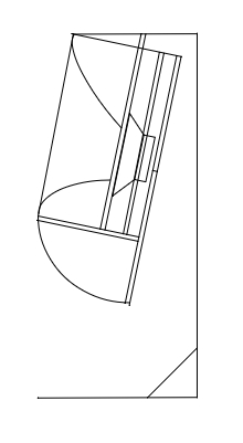

I once built a guitar cabinet using 4pcs 6.38, with a small frontloaded horn and a backloaded bass horn, about the size of a single marshall cabinet. I painted it orange and called the cabinet Maxima.
measured >134dB in front of the cabinet...

maxima was a little short on the low end, especially as the guitarplayer tuned a bit lower, typical for stonerrock. it would need a much longer bass horn
in the early days a jcm800 was doing the job. plenty of headroom ...

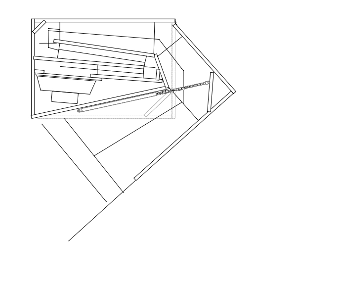

here is a small drawing of the maxima. the driver magnet was sticking through a panel to get a minimum back chamber volume.
the guitar player still can hear as the sound source was placed low. ...

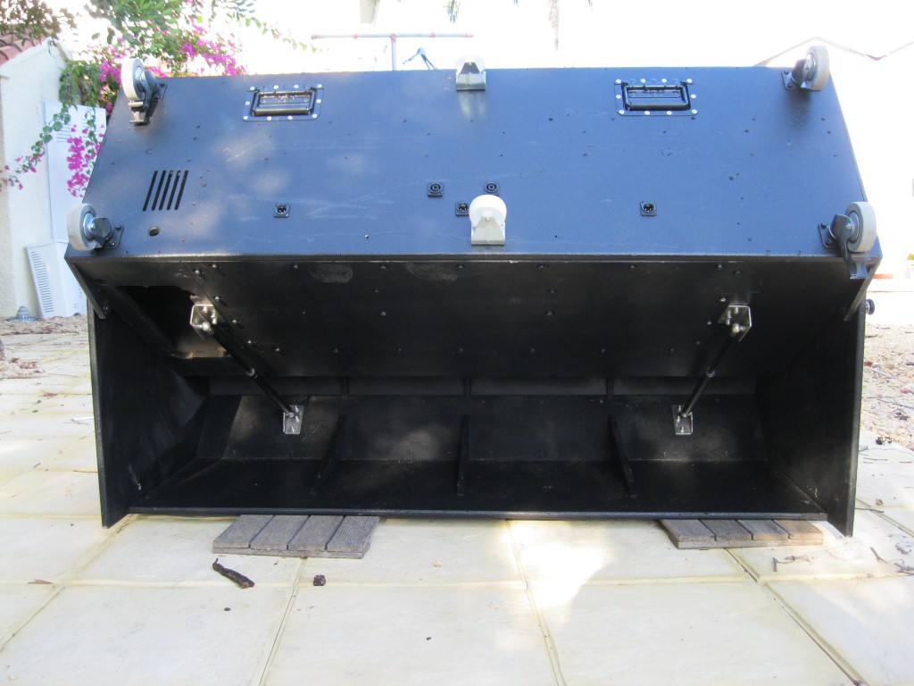

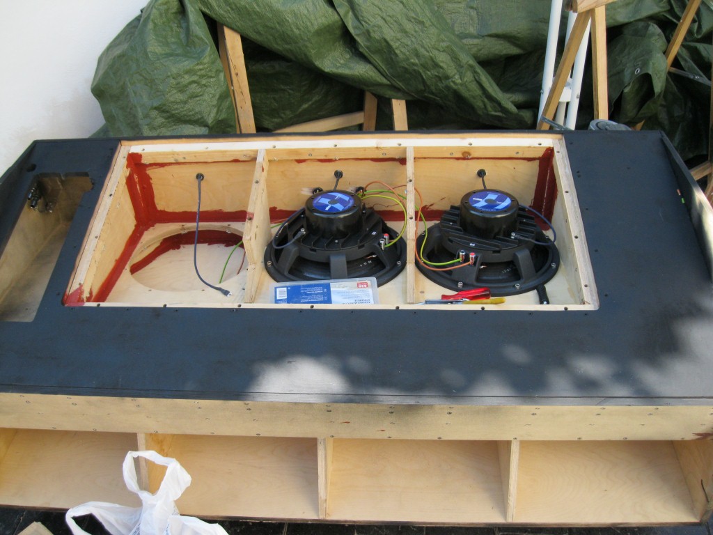

one of my later designs a 3kW folding horn, 3x12" beyma ND. heavy beast, I did prepare it for watercooling the magnet assy's using PC modding kits. I have tempsensors on each driver that can be monitered using the XLR plug.
Really good project! Bloody tempingthanks again - I found that driver on a horn similar to my my 250Hz Edgarhorn from ~1991. Comments implied the sound was very good on snare drum.
Speaker project: Eminence 12CX in 125 liter cabinets + FaitalPRO M5N12 in 300Hz Edgarhorns - Album on Imgur
sorting out the proper gas springs, I ordered a custom stainless steel hinge, and added a rubber slab over it. in the end I had to add 2 more wheels in the center ,as the long contraption got stuck on the ramp to the truck.
