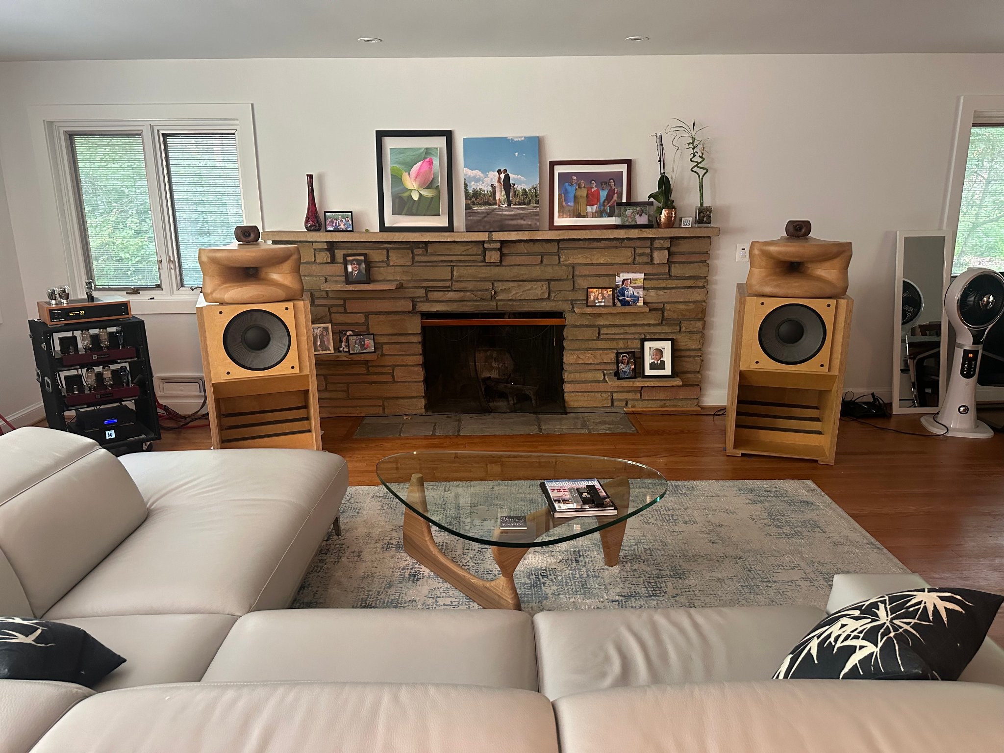

The only system I heard of Troy’s was quite different; in a customer’s room back in March. https://josephcrowe.com/products/speaker-system-no-2095 While that 3-way system sounded completely devoid of coloration and most of my recordings were very listenable from the lower midrange on up, Glen did mention that Troy advised him to add subwoofers as the bass was much absent. But while then concentrating on what I heard above the bass region ( https://josephcrowe.com/blogs/news/lens-no-1896-for-fostex-t96a?_pos=1&_sid=dd4de98b8&_ss=r and https://bcspeakers.com/en/products/hf-driver/archive/2/8/DCM50 ) during Glen’s generously session time, I kept wishing to have been able to compare the sound of my WAV files of CD track rips to two-way systems using drivers (beryllium Radian, 18Sound JBL) I’ve never heard.
Glen’s speakers were ~ 10 ft apart on the long wall of a room 23 ft x 31 ft, though two walls opposite the long wall were L-shaped. 8 ft ceiling; no room treatment. However, as Glen said that he found the extreme right side of that sofa (attached photo) to be the sweet spot for the ES450 horn, would not the smaller ES600 horn have an even narrower directivity?
In any case, I have no chance to hear Troy’s proposed smaller ES600 horn speaker design. However, given my room and degree feasible room treatment, preferred speaker placement, listening location, use of multiple subwoofers attached sketch of the room and list of its features, I am hoping for suggested horn/driver combos compatible with my midwoofers and my room to achieve the least compromised horizontal and vertical constant directivity coverage pattern.
