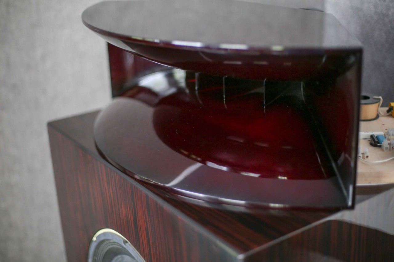

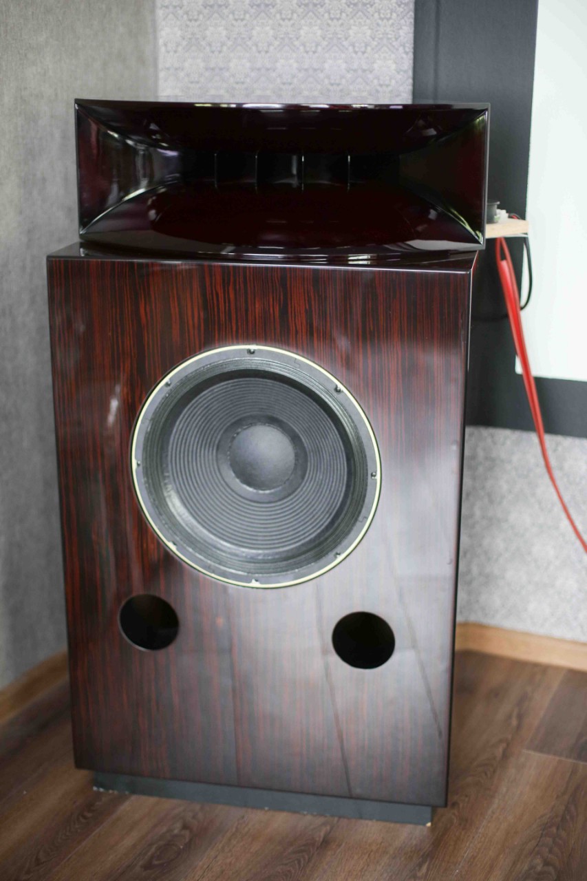

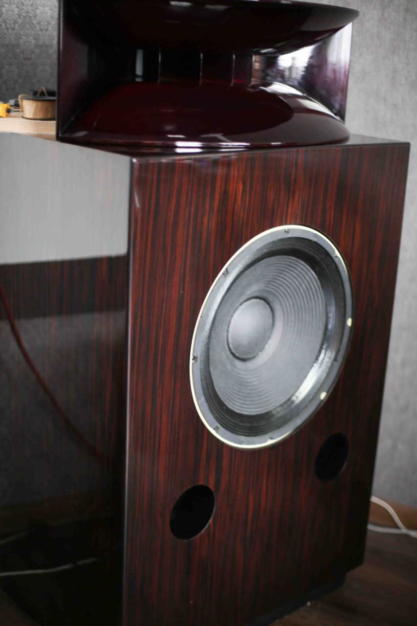

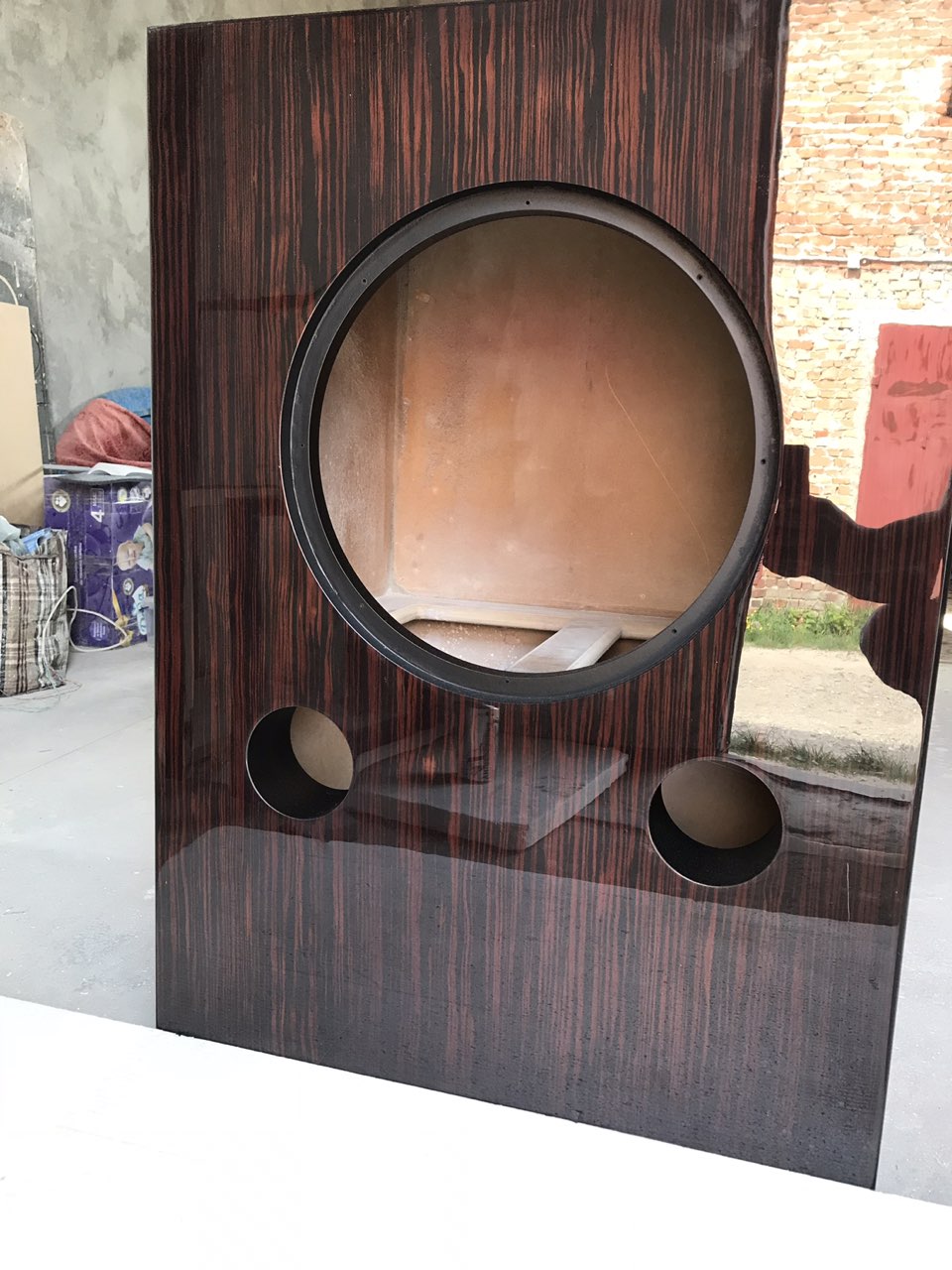

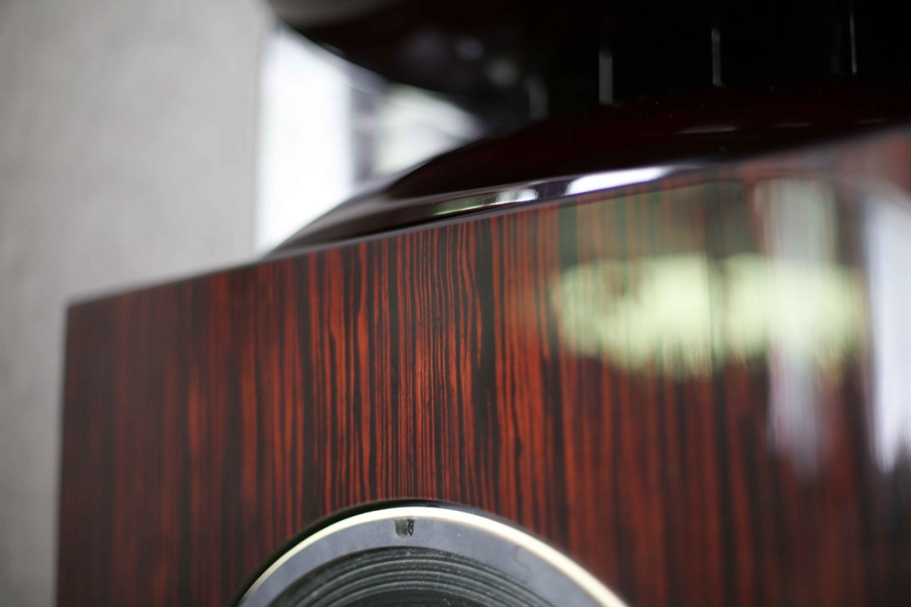

And so it all began with the selection of material for hulls and horns. It was decided to build a low-frequency section from sheets of thick 30 mm MDF, covered with a good veneer of the Ebony tree, painted in not less than 20 layers of varnish to give acoustics a proper look. The GAUSS 5831 15-inch speaker (97 dB sensitivity, range from 35 to 3000 Hz), which has an Alnico magnetic system recognized by audiophiles, was taken. It was very problematic to get it, since this speaker has not been produced for a long time and immediately flies away from sales if it appears on auctions in Japan or on Ebe.
The weight of the LF section was about 90 kg + dynamics of 13 kg. The total weight of one LF section has exceeded a hundred square meters !!! The volume turned out to be about 250 sheets, which is ideal for dynamics of this size. Paint was carried out in a layer with subsequent grinding and the expectation of drying the previous layer for at least a week! The MH / HF range is trusted to reproduce the compression driver of the American firm Radian-850PB 16 ohm (sensitivity 113 dB, range 500-20 000 Hz), loaded with a manual A-290 muzzle, analog TAD-4001. Due to its design, this horn is able to reproduce the range from 300 to 20,000 Hz without distortion. The chopper, like the body of the LF section, was built precisely in accordance with the original drawings of Yuichi Arai.

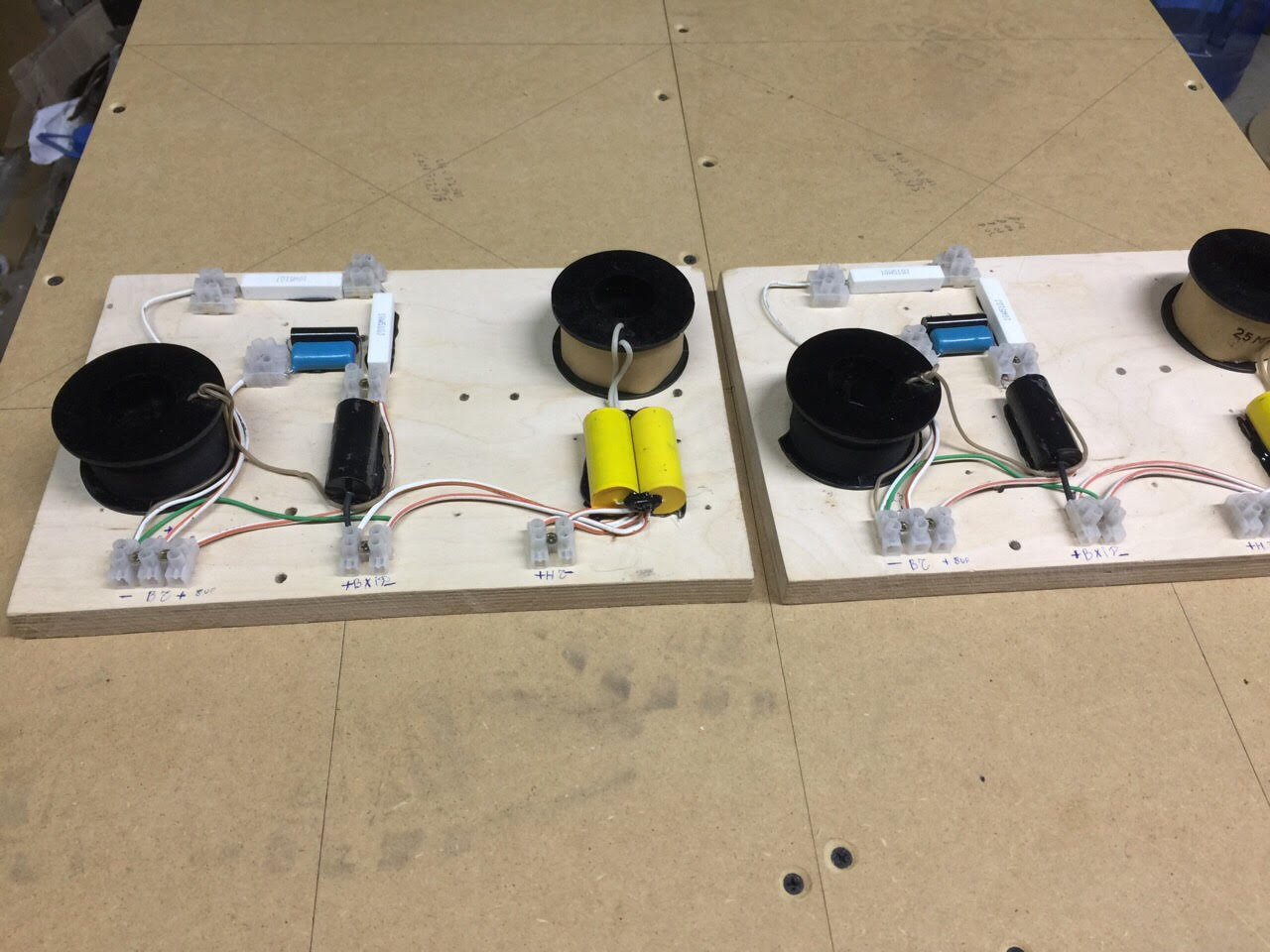

By the way, I still do not understand people who build systems at random in the garage, without drawings of eminent firms or engineers, based solely on hearing and their opinion. The average sensitivity of the system was about 98 dB. The separation of the bands was carried out with a crossover of 3 orders (18 db / octave) at a frequency of 800 Hz. There were fears that loading a low-frequency speaker up to 800 Hz would have a bad effect on the sound and that one Radian-850PB driver could not cover the range from 800 to 20,000 Hz. But these fears disappeared after the first turn on the system. Running forward I will say that the thought of creating a separate third of the band for HD reproduction was lost right away! The Radian-850PB driver calmly cope with high frequencies and is able to independently pull a range from 800 to 20k Hz! Especially since there is only one cross-linking of the bands in the system. Well, now it's time to turn on the system! The first thing that struck this openness and the magnitude of the sound. As if from the columns removed a blanket and they began to play easily and intuitively.
I was worried that the MH / RF horn would not be able to produce worthy RFs, but the bells and other RF sounds turned out to be detailed and high. Well, now a favorite theme, for what in principle and this system was built - vocals. He turned out to be so realistic that it was just like the ant skin. The vocalist in the center, the voice of the voice is correct, the slightest breaths-exholes of the artist can be heard. No hole color! LF is not something that moves the sofa (as a matter of fact a fabric pendant and diffuser paper). But they are fast, flabby and so truthful that when the wand hits the drum in the composition, you start looking for a drummer in the room))) The drum used to be so realistic. At me the amplifier for the present time not for these kolok - Primare 30.5. I think his replacement will add a little bass. Well, plus general warming will improve the situation. Although now the bass is at its height. I hear bass and not hum. In general, the conclusion is that for the first time in the path of my "audiofilm" I realized that I no longer want to search for anything. The desired sound is found !!! I never thought that I would reach the rumors and that they would shut me up. But I'm very glad that thanks to the mentors I found myself in this "sect", the hunters will understand))))
