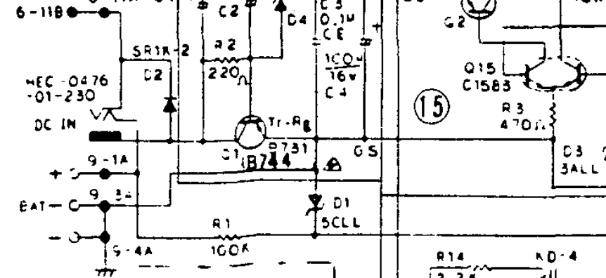

I have an EX-800 and couldn't get any sounds from it. I tried to fix it but unable to do so because transistors like B744, B731used in this diy are either expensive or out of production. As a cheap alternative of these components I order few components like BD170, BD190, MJE254, MJE711 and MJE712 from utsource. I hope this will help me to repair my diy. Any advice will be appreciated.

I searched 'Korg EX-800 repair' and came to know that the regulators commonly fail in these model , especially B731 and B744.
I was planning on replacing the 100 uf capacitors that are near the power inlet as well.
Don't know whether TO-126 is an all epoxy package or if it has a thermal slug. I need to know more about it.Thanks for the advice though.
