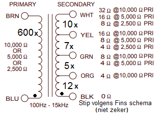

I don't know if this is common knowledge, but the current thread on the Hammond 125DSE inspired me to post this little hint. For the Hammond 125xSE transformers, connecting an 8 Ohm speaker to the 32 Ohm and 4 Ohm secondary leads (ignoring the Common lead) gives a 6k primary impedance (5982 Ohms).
Here a drawing with the number of windings between the connections.
Is this case from 4Ω to 32Ω we have 5+7+10=22x giving a transformation ratio of 600/22=27,3.
If you connect 8Ω then the ptimary sees 8 x 27,3 x 27,3 = 5950Ω
Not shure if the same wire is used to get from 16Ω to 32Ω, there is much less current needed for a 32Ω load.

Another option is to connect your 8 ohms load between black and yellow and use the white 16 ohms tap for CFB. By doing this, the secondary winding effectively gets connected in series with the primary and thus increases primary inductance and turns ratio. The CFB lowers distortion and output impedance, at the cost of gain of course.

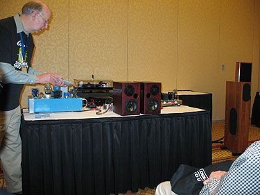

Here's an early demo I attended. The idea was to compare push-pull and parallel single-ended sound. The results were interesting, but would need much more time to draw any hard conclusions. Interesting nonetheless! PP sounded better on mono sources, and PSE beat it out on stereo sources- even when only one channel was playing... strange!
https://www.enjoythemusic.com/vsac_2008/
