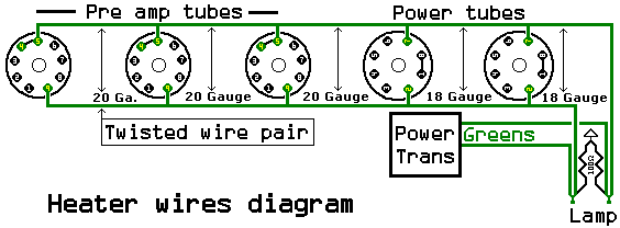

22 gauge for signals, 20 for preamp valve heaters, 18 for power valve heaters.

600V;20 AWG wire would certainly be OK for preamp valve heaters, but 18 AWG is recommended for power valve heaters. See the words of wisdom here:
Heater Wiring - the Good the Bad and the Ugly

Even #20 is fatter than preamps or most power amps, need. #26 will easily carry 1.2 Amps (four 12A*7 or two 6V6) a foot out and back at <2% voltage drop.
Filament wiring gauge
Voltage Drop Calculator
