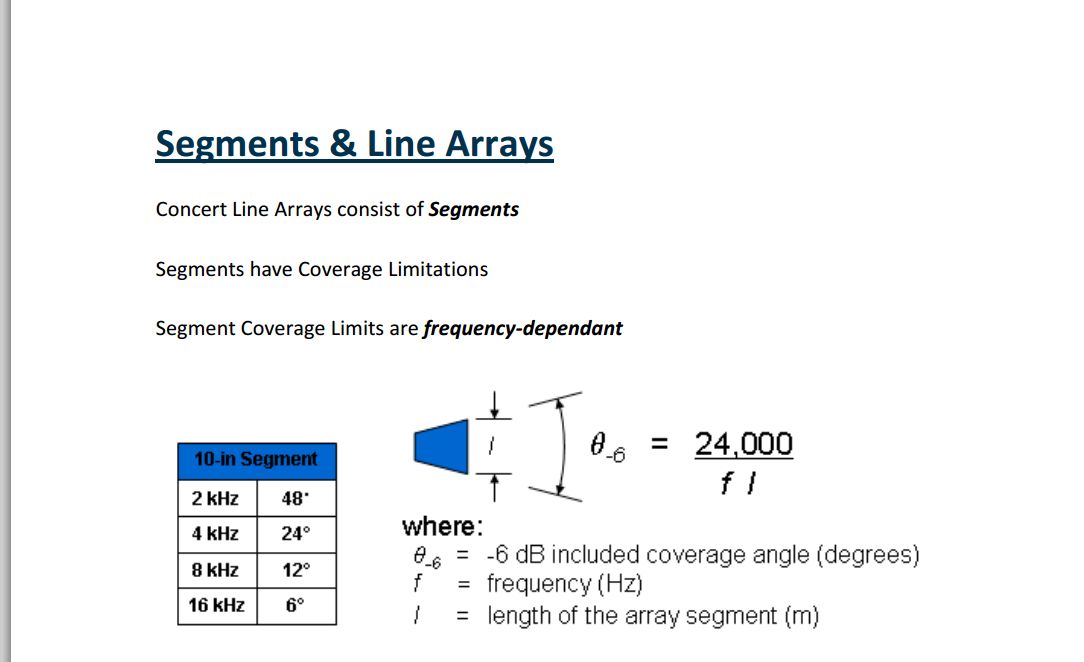

Here is the Formula I had mentioned to you in my PM for a good generalization of dispersion angle vs Frequency and driver width.
It is fairly accurate as it might not be as precise as the true formula but i did use this to do a few maps and they came out just the same as a spreadsheet that I had found and use for more accurate predictions now.
The spread sheet was much easier and faster to use than doing each point for the graph by hand!! He,he,he,he 🙂
The formula is found on page 6 of this document,
https://www.google.com/url?sa=t&rct...n4HAAw&usg=AFQjCNHUcKfnIVX3ZyZPZNlkU-w4mGoyow
The spreadsheets are called "Vertical Polar Response:line array" and "Asymmetrical Response
Pattern Estimator" VPR and ARPE and can be found here,
FRD Consortium
These tools are great and took all of the guessing work out of the question of dispersion.
jer 🙂
