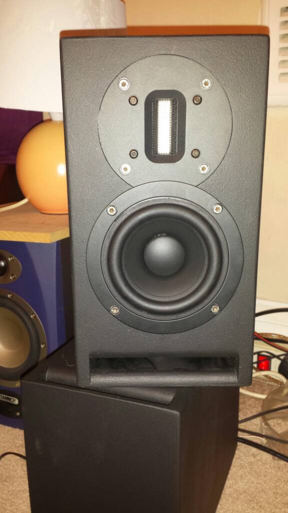

After this crash with the paint, and some forums, i went with .... masonry paint! 🙂 Super fine outdoor masonry paint. And it did the job. Look nice matte color. Dont pay attention to the port color, it got fixed, pics will fallow later.

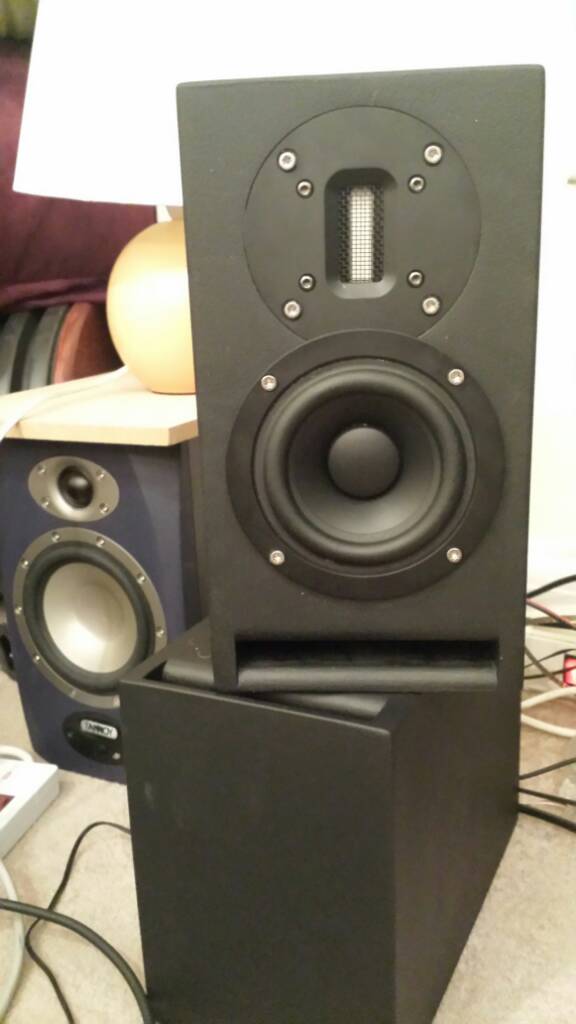

Btw drivers will be fixed with torx screws and t-nuts. Had to shorten the nuts for the tweeter. But filing was quite easy. Cabinet does not have any access panels or walls.
Be sure to secure the T-Nuts with some epoxy. Nothing worse than pushing a T-nut out and having to use a lot of force or drill or whatever to dismount the driver.
What do you mean? I got tge behond the drivers and it look solid. It shoukd not come out. I can use a lock tight on tfe bolts. But i think this is an overkill. It ment to be fixed with screws and i got m4 bolts. Here is the final look 🙂Be sure to secure the T-Nuts with some epoxy. Nothing worse than pushing a T-nut out and having to use a lot of force or drill or whatever to dismount the driver.
