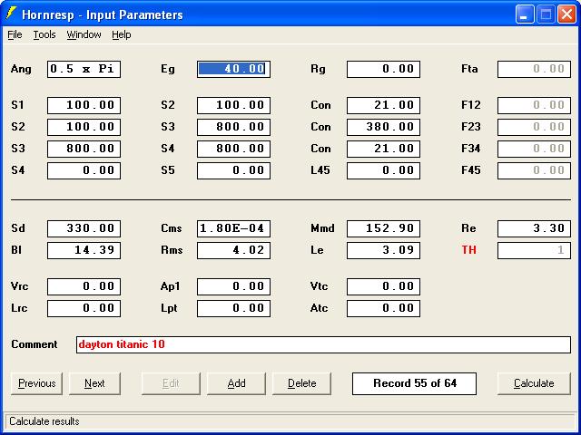

i just built a 5 foot by 3 foot horn for my Eminence Lab 12 (the thread is here...http://www.diyaudio.com/forums/subwoofers/143714-lab12-tapped-horn.html)....powered by one channel of a qsc rmx 1450....its awesome!!! if you have the space go for it. or even a pair of them, that would be killer!
i have the big one paired up with two tang band 38hz 6.5" horns as well. the large one under the TV in the front of the room and the two smaller ones in the rear. plenty of bass in about the same size room as you have.
the lab 12 is like 165 usd shipped from parts express....so thats right around your budget.

Thanks for the input so far, has anybody got any experience with anyother (possibly cheaper) drivers in the lab12 tapped horn? Also anyone familiar/build lilmikes Cinema F20 sub? found here (just discovered it today) any other potential drivers for this known?

HWK15
and almost any 15 you can find

Thanks for the all the tips so far. Was looking into the homewrecker last week, do you know the recommended driver specs? Also couldn't find a great deal of feedback on it, is it as good as it makes it out to be? 🙂
ive built and used 3 housewreckers.
a 15, a 12 and an 6" version, they are all excellent.
easy build, and work well with almost any driver (subwoofer)
