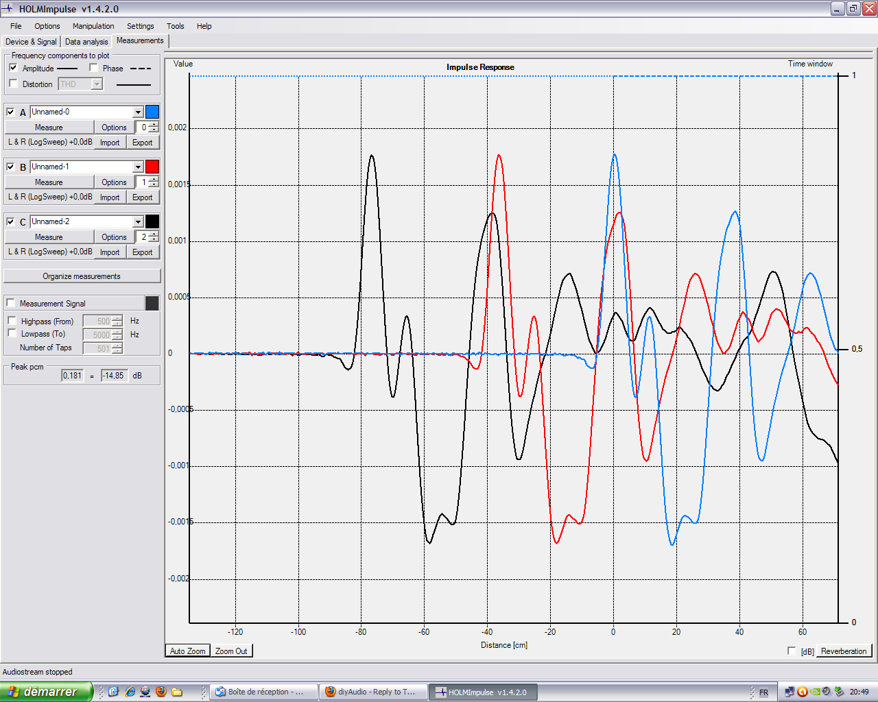

I use Holmimpulse to make my time time alignment of my drivers. But today I bought a ECM8000 with an USB interface Tbone micplug. My probleme now is when I do 2 ou 3 measurements of the same driver , the offset is always different. The offset mooves at each measurement. When I use my old mic pluged to the RCA input of my PCI sound card, evething is fine, each measurement has the same offset.
Could someone can help me ?

I'm not sure what you mean by offset. Is the offset in the frequency domain (i.e. SPL measures differently from measurement to measurement) or in the time domain (the pulse response doesn't line up with the previous measurement)?

Yes the probleme is that the time domain,,, the pulse response slide at each measurement,,,,
Have a look on the curves, I write the same offset value on the 3 curves. Of course it's the same driver without moving anything.
When I use my other mic that is pluged to the soundcard, the 3 curves are totally superposed with the same offset value.

So with your XTZ, for exemple if you make 3 times the same measure with homlimpulse of the same driver, the curves are absolutely superposed with the same offset value ?

I had this problem when i was using different sound card for playback and different for recording. Do you use same device?
