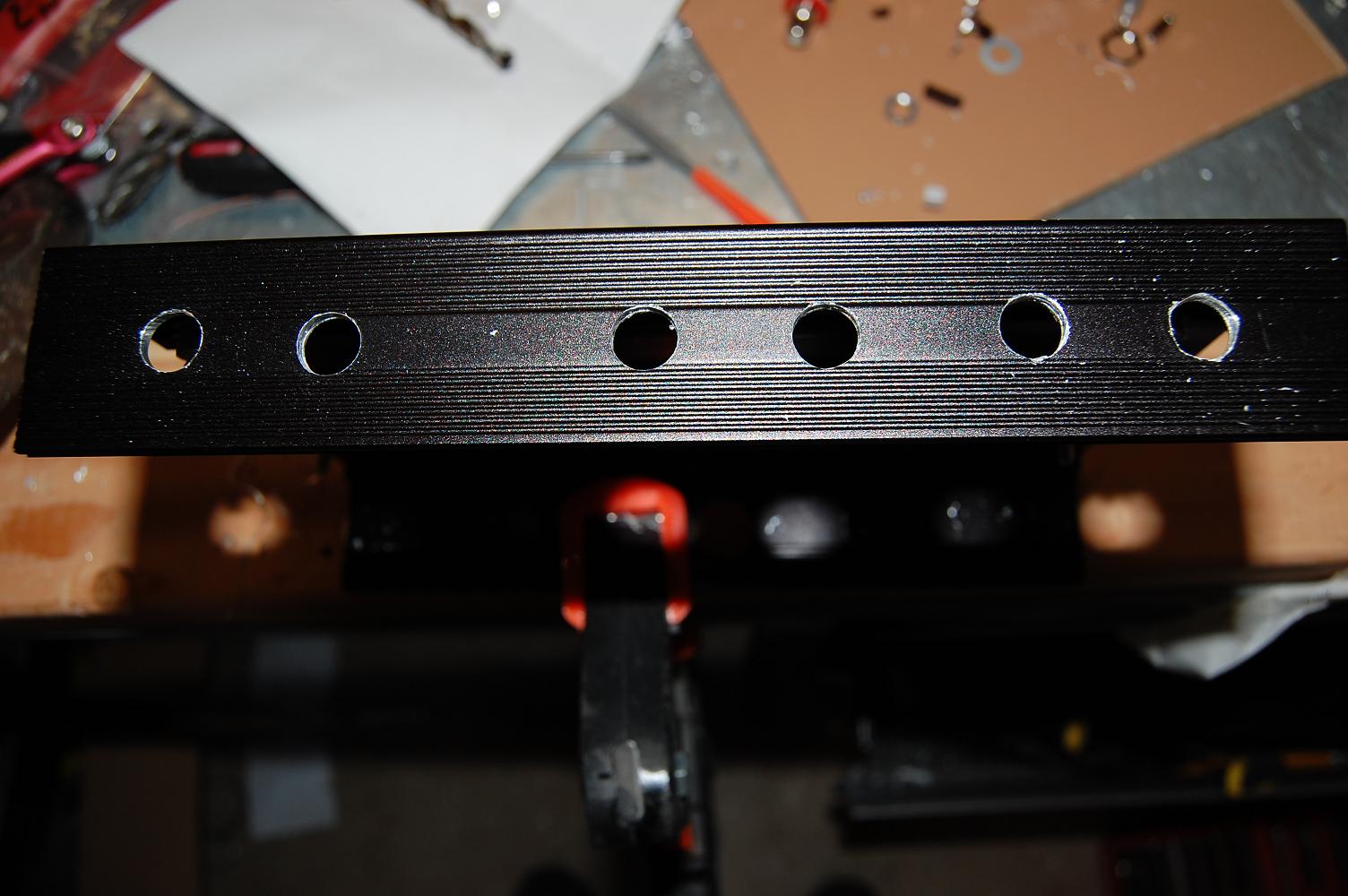

I used a center punch to align and still not good aliment on a manual drill.
Question is basically, even thought I'm good with tools, I'm not getting professional results.
I'm just asking what is needed, for example If I was going to do a few to sell. The small scratches and imperfections won't allow to get good price.
Also would like mine to be perfect 🙂

Are you using a hand drill or press?
doing by hand. I know a drill press will help.

I don't like drill presses for holes under 1/2" dia (13mm). Unless you take the time to clamp the vice down, they just slide around when the drill catches at the bottom of the hole. I use a variable speed hand drill, slowing down at the bottom of the hole. If the drill walks at the beginning, see the previous about starting with tree grinding bit. When I resharpen drills, I make them pointier than 135 degrees because that centers better and requires less force to start the hole. Your burr on your right hand hole could probably have been eliminated by drilling undersize then finishing with file or diamond grinding bit. Also start from the appearance side, sometimes the final part tears out instead of shearing.

I drill a hole of the desired size in a small piece of hardwood (about 3/4" or 20 mm thick), then clamp the panel between that and another (not drilled) piece after centering the hole exactly where I want it. Then just drill down through with a handheld drill. The hole in the wood aligns the bit and prevents it from wandering throughout the process. The wood underneath prevents the bit from jamming and/or tearing up the piece as it comes through the bottom. I get a perfectly round hole with nice straight sharp edges, even on very thin panels (0.5 mm or less). I use this on plastics, aluminum, steel, etc. of virtually any thickness. With some care, you could even drill perfect large diameter holes in thin, brittle acrylic panels without cracking them. With this technique I find that high drill speed generally works better than slow, with consideration for bit diameter and work piece material of course.
