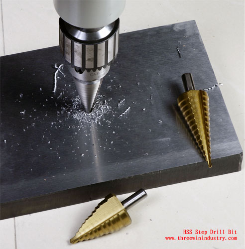

This is what I use:
http://www.harborfreight.com/cpi/ctaf/displayitem.taf?Itemnumber=96275
I only use these step drills in aluminum. They make a lot of chip. Be prepared for it. I haven't tried anything thicker than 1/8" aluminum, and I've never tried a steel chassis. With these things in mind, they've served me well all the way up to 1 7/32" holes for big octal sockets. I've been told that quality Greenlee chassis punches will do a better job, but I'm not willing to shell out the coin.
I'd imagine the hole drills you linked would make less mess, but make sure you buy the right sizes you need for the job. I'd like to have appropriate sizes for two kinds of octal sockets, noval sockets, transformer lead holes, power switches, and speaker binding post holes.
They really do make smooth looking holes. I've never had a problem getting them to land where I wanted them. You can use the next size step to de-burr the size you just drilled. Just lightly touch the hole with the next bigger step on the bit. Flip the chassis over and de-burr the other side too - it makes a nice smooth hole which won't nick wire insulation. Maybe the particular alloy of aluminum helps make clean holes?

I'm drilling into 5mm aluminum. I want to use what ever will give the best chance for success the first time around, as the plate is a part of a very expensive chassis and cannot be replaced easily!

The Harbor Fright punches will NOT go through 5mm aluminum. I managed to drive them through 3mm, but it took a 15 inch ratchet handle and a lot of swearing. The hole was serviceable, but had four obvious bite marks where the punch went through.
The other bad thing about the HF punches is that they are not sized appropriately for tube sockets. The little one is too small for anything, and the big one is too big. The second smallest might pass for noval sockets, but is a hair large. The second largest just barely fits an octal socket, but you have no room for error.

Aluminum is very soft/forgiving, so many wood bits should
work fine in aluminum as well. If you have a drill press, I think step
drills are the way to go as you can clean up the hole with the next
size up. Finding a step drill for larger sockets can be expensive, though,
which is why I went with a hole saw.
You absolutely need to practice and make sure the final hole actually
fits the socket you want, particularly if you are under-mounting. For
lubricant, I just use WD-40 and it works great. The big trick is to avoid
heating the aluminum too much, as it turns gummy when hot and you
end up with an extruded mess on the back side which takes significant
clean up grinding. I learned this the hard way.

I'll vouch they work in 3mm aluminum. Half inch holes are a dawdle. If you want to make 1 7/32" holes, you'll need something to clamp the work piece, or a small press stand, or preferably both. I used the press stand and held the aluminum plate with gloved hands. If I had to drill 5mm aluminum, I'd try these before I went with a punch. I'd still be happier if I had a scrap piece to test first. You might have to drill from both sides - I'm not sure the steps are more than 5mm tall.

I'm taking a guess that the stepped bit is easier to control than a hole saw? I'm thinking things could go wrong FAST with the hole saw!
But!
would the steps be deep enough? i'm imaging the nest step past where I need to be bearing down on the plate as the last step just breaks through?
